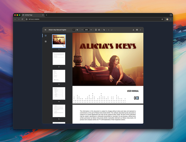

And oh boy, I’m not a Chrome user, but how much better an embedded PDF looks in Chrome. Thats just like Preview app.

Try adding your pdf in my actual test project and see what happens there.
See I told you I was brain dead! :slight_smile: I did not see your test embed. I added my Dutch pdf and it worked. I now want my accordion style to show PDF in right now window. but copied tour text in and got same message (file not found” I attach my accordion - very basic at moment but the way I want it but thought I would try PDF embed first before going much further. I attach file for the code and I have changed accordion one HTML Code to what worked in your test. TIA

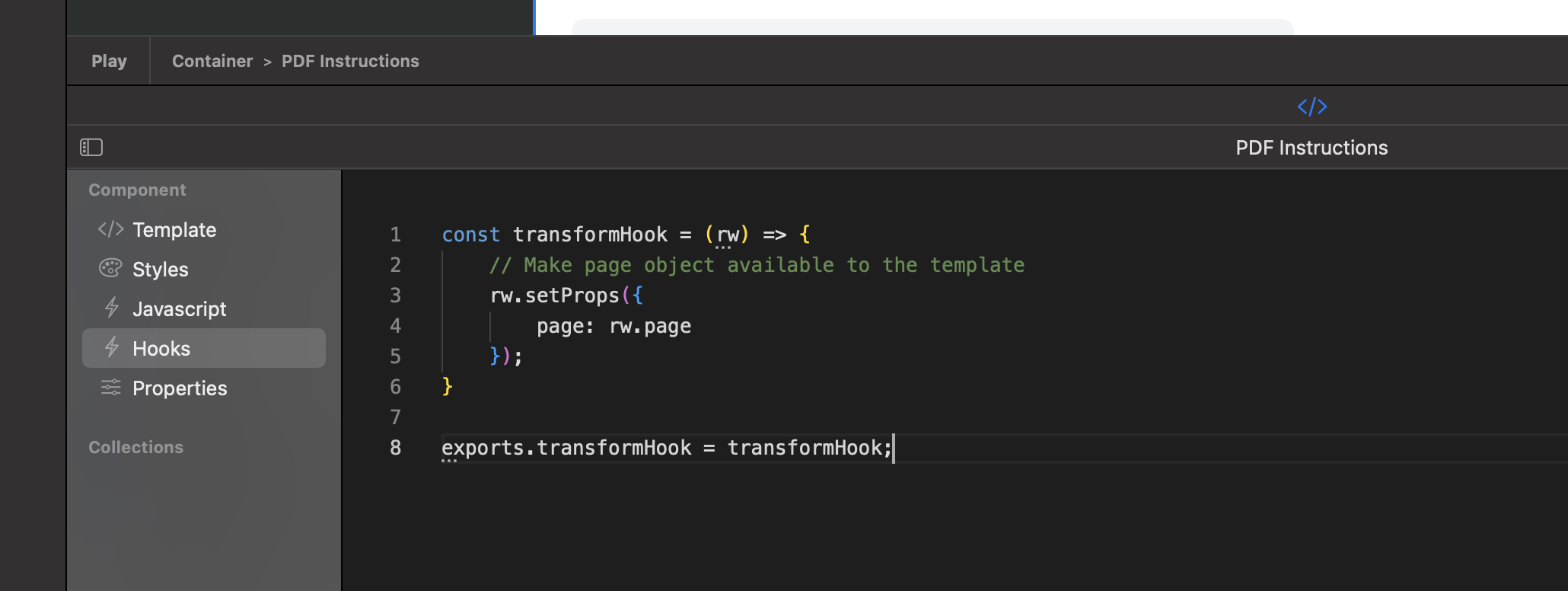

add this to your page instructions hooks file:
const transformHook = (rw) => {
    // Make page object available to the template
    rw.setProps({
        page: rw.page
exports.transformHook = transformHook;
This allows you to get the url to the resources directory for the page.
Thats it, well so far you only have the correct url for the pdf inside your “Load” accordion section.

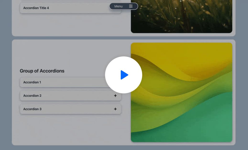

I finally have a working version of a multi-accordion group with an associated image.

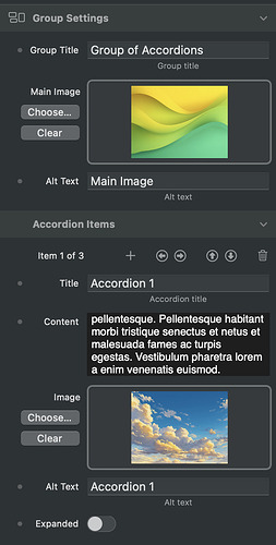

I ended up going down a rabbit hole, deciding that, for it to be really useful, you needed to be able to create as many accordions as you required. To do this elegantly in Elements, you need to use a COLLECTION. So that is the route I took. Took a lot of studying to figure out how to use a collection.
By using a collection, you can specify the details for each accordion through the item properties, using the collection property inspector you can then create whoever many you need. It allows you to enter a TITLE, CONTENT, an associated IMAGE (other things in the future), and whether the accordion is initially expanded or not.
This is what it looks like in action.
Here are the current properties for the component. I will gradually add all the styling properties so that, eventually, all aspects of the element can be controlled.
This was an interesting project. Still lots to do, but it is now functional enough for my use case.
