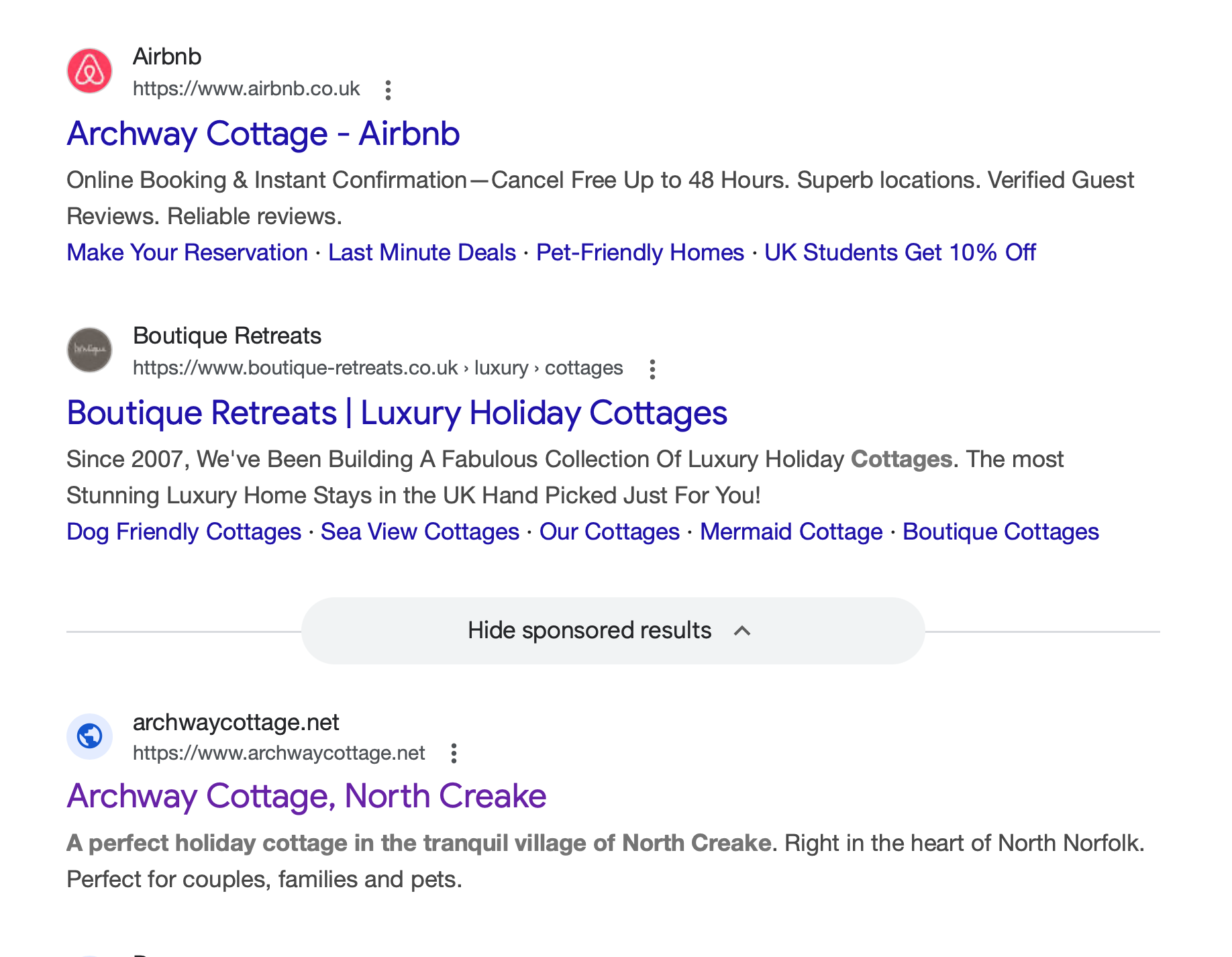

Hello, My favicon icon shows on safari tabs and I have uploaded all files I think. Google suggests that the file should be at the root folder, or that I should add some code to the header
Can someone take a look to see if I have gone wrong - I added the website to google search console and it says it has crawled the site. I have also uploaded a robots/sitemap file etc.
https://www.archwaycottage.net
Here is the screen shot of the SERPS page

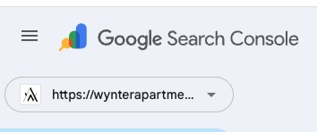

I found I have the same issue. I have two sites, one used the other as a template. The favicon settings are exactly the same in both. Oddly, only one shows the favicon in Google search, or DuckDuckGo for that matter. No idea why but I had the non working site open so threw that bit of code in and republished. Went to get it re-indexed and this is what the Google Console was showing me this with a working favicon -
So who knows where it is picking it up from?

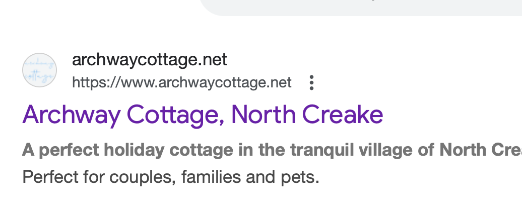

OK - I uploaded a favicon (this one https://www.archwaycottage.net/favicon.ico) and updated the robots file as suggested. I now have a logo showing on the SERPs but its using one that I did have uploaded on the site but have since changed as its unreadable that small. I assume it will naturally update in time?
I would just double check that you don’t have that old favicon somewhere in the settings of your site then I would possibly resubmit to Google and give it a few days. Looks like even though the old one was not showing Google had cached it away and used that when you made a request?

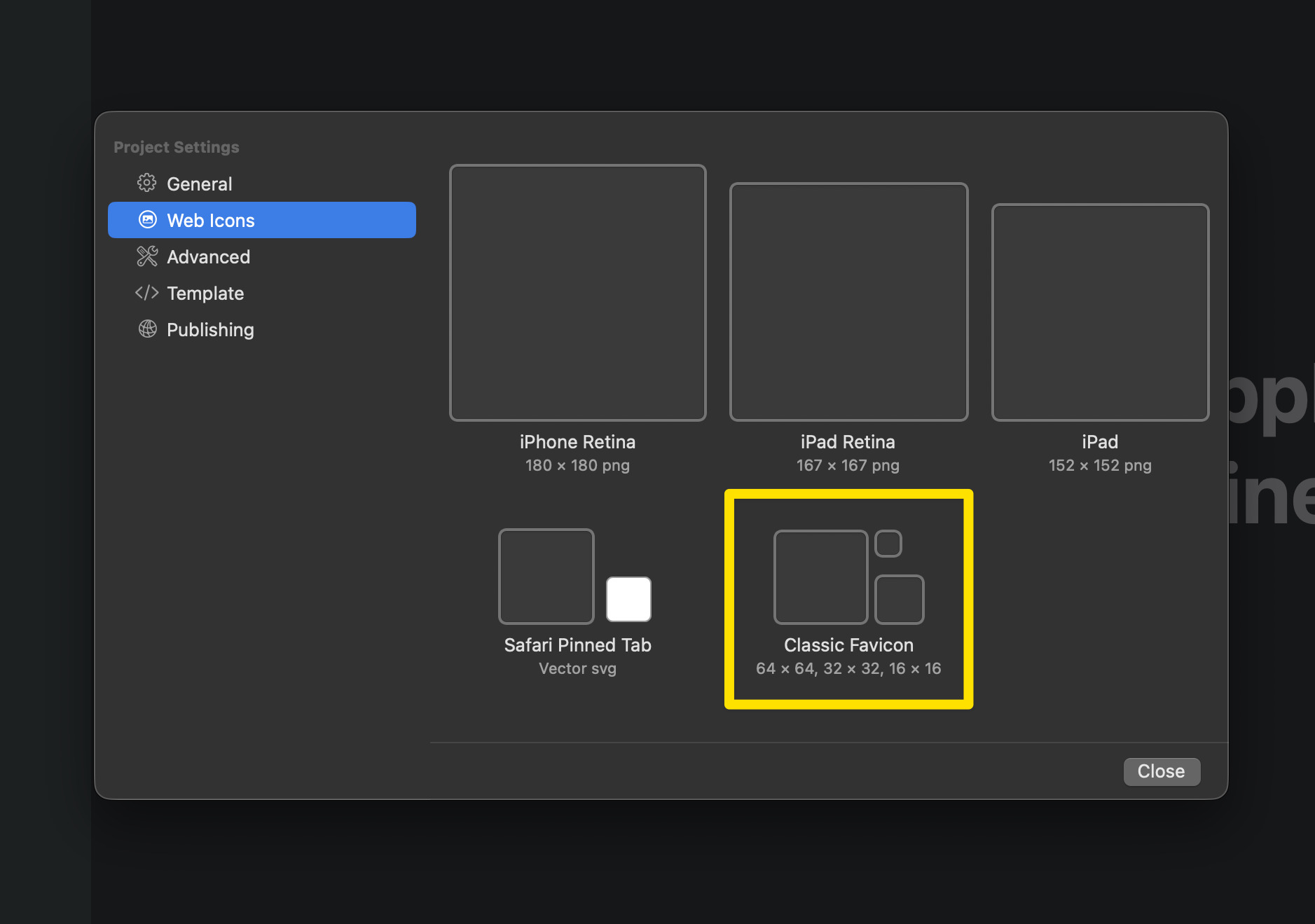

I have been working on updating my own Favicon app. It’s a free app, so am able to let you have the .ico generation part if you want it to get the classic favicon.ico working in Elements project settings > web icons.
I have tested the classic favicon in elements, and it does not “appear” to do anything at all apart from add the three images to the resources. favicon.ico file appears in the root nor is it linked to in the head markup.
With this you “could” reduce the classic favicon wells to a single image well. and pass it through this function.
