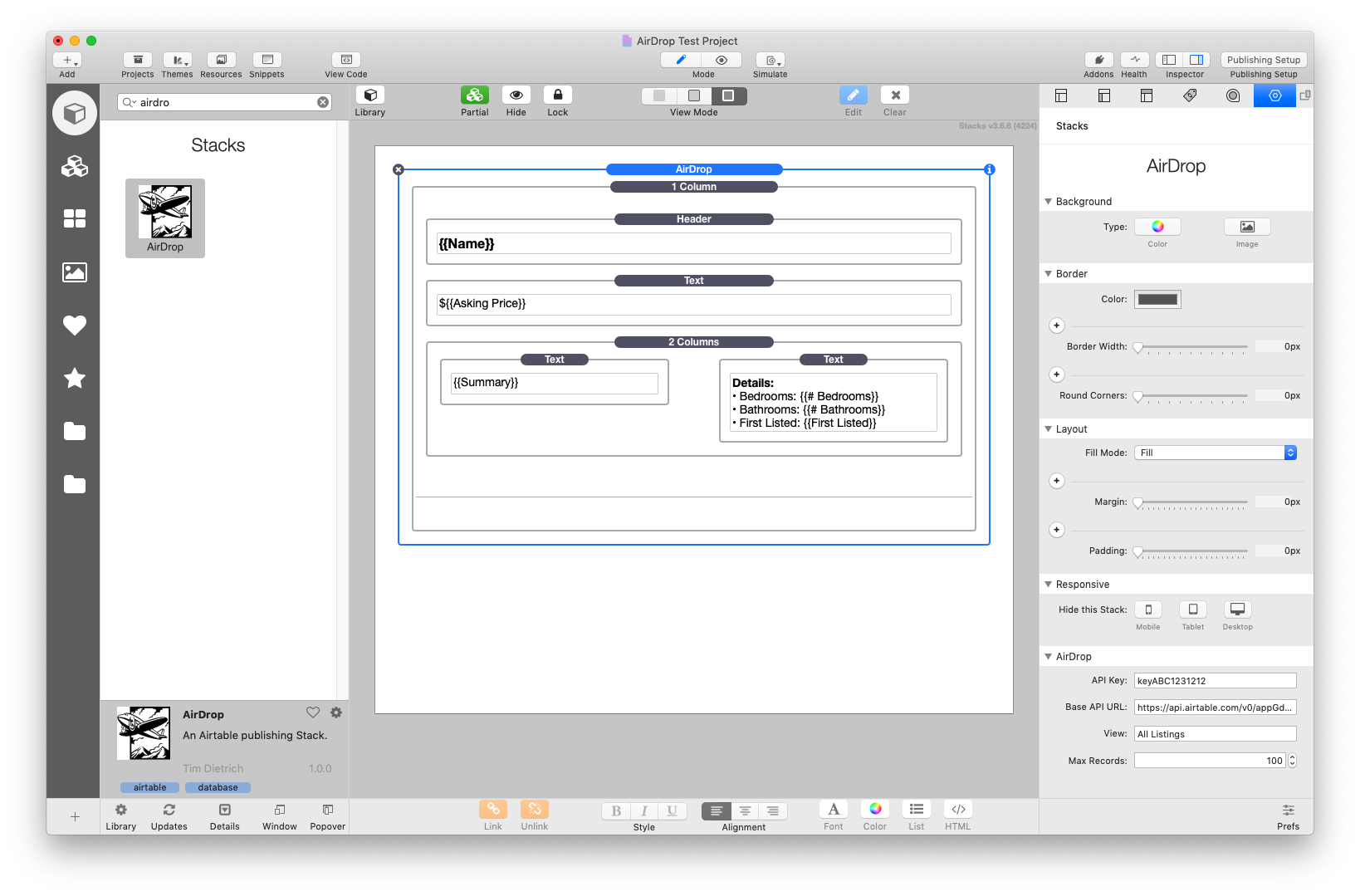

I’ve put together a very basic stack, which I’m tentatively calling “AirDrop.” You configure the stack by providing a few details about your Airtable database, such as your API Key, API URL, the specific view that you want to use, and the maximum number of records that you’d like returned.
Then you drop in whatever stacks that you want to use to display the data. For example, you can use a header, paragraph, and even HTML stacks. And finally, you add tokens to indicate the fields that you’d like to display, and where you want them displayed.
That’s all there is to it.
I’ve attached a few screen shots that show an example. In the example, I’m using an Airtable database that is used to keep track of real estate listings. There’s a screen shot showing what that database looks like, another that shows the RapidWeaver project file (including the “AirDrop” stack and how it has been configured), and one that shows what the fully rendered page looks like.
