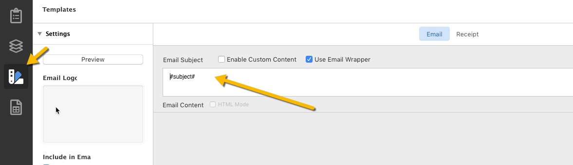

Not sure what you have tried.
I don’t have a test site setup with FormLoom 4 to check but I think you would go into the templates screen and in the eMail Subject you would just enter #subject# (or any field name you used).
Thank you @teefers … that must be about the only thing I did not try, worked right off the hop! Much obliged! peg
