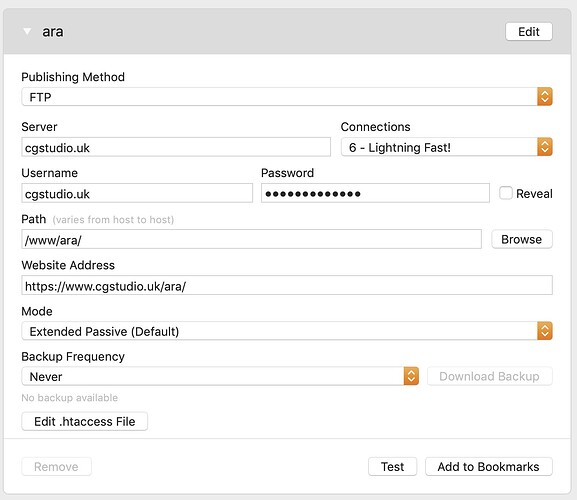

I have tried relinking to the correct directory, the password and other settings are correct and I tried changing down to a fast upload.
The host company is Andrews & Arnold

I have not changed any of the settings up to the point the problems occurred. The server has seemed ambivalent at times about the user name; sometimes it is cgstudio.uk and other times it is www.cgstudio.uk, I have sites answering to both. The path is correct but when I rest the path earlier it dropped the last / but I see it has now reappeared.
My best guess since the test works, the credentials are okay. The path is probably the issue.
Try clearing out the path and hit the browse button. It should come up with a directory list of where your login starts out. Then select the directory you belong in. You might see www first and then the ara.
Selecting it this way should come back with the correct directory name filed in.
