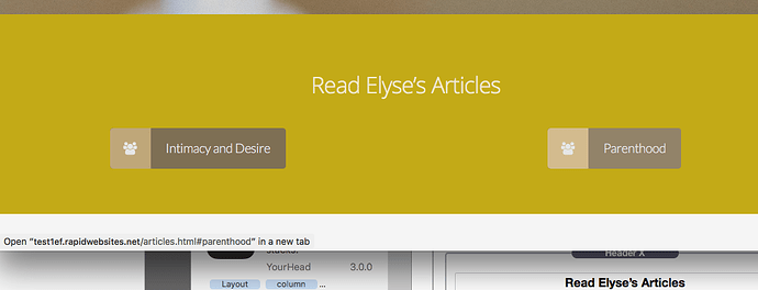

Tried both with http://test1ef.rapidwebsites.net/articles.html#parenthood and also without the .html but still no luck??? See screenshot below,
I am just not sure how this JW Link works, I’ve read his documents and read forum threads but this little stack just seems to be a tricky little thing.
Any ideas or thoughts welcome.
Cheers Scott
I can’t get your URL to work on my computer to look (even the test1ef.rapidwebsites.net/ does not show up for me).
If you hover over your link, what does the URL say in the bottom left of your browser?
Hey mate, I really appreciate your help and responding so quick.
I don’t have the site uploaded at the moment, I’ll do that shortly to test but in RW this is the link I get when hovering…see screenshot
Hmmm. I know I’ve used that stack in the past and haven’t had issues but I’m not at my RW computer right now to check settings. The only other question, maybe, is if the page is set to .php instead of .html?
