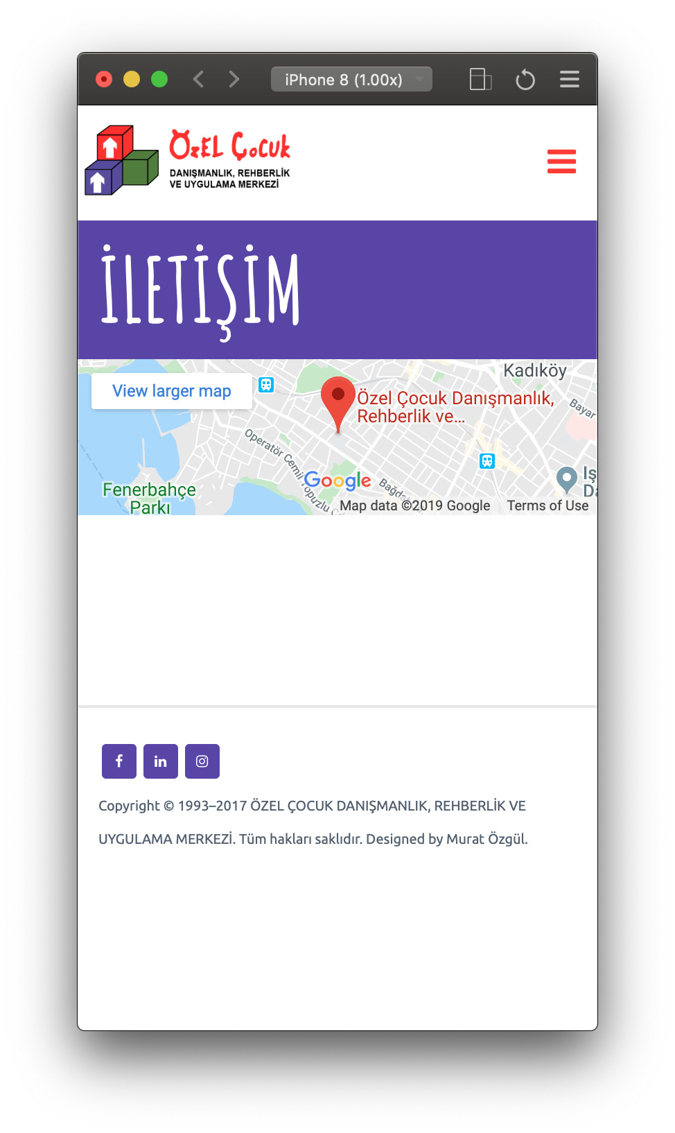

Sorry guys I forgot to mention what I am trying to achieve exactly. I am trying to make Google Map with iframe. I made it edge to edge and also responsive. But now my problem is when I check on the mobile preview it looks so small; is it possible to set height in mobile previews?
I used these settings;
.map-responsive{
overflow:hidden;
padding-bottom:30%;
position:relative;
height:0;
.map-responsive iframe{
left:0;
top:0;
height:100%;
width:100%;
position:absolute;
This is the look from the desktop;
And this is from mobile;
As you can see mobile version height is so small. What can I do for this?
