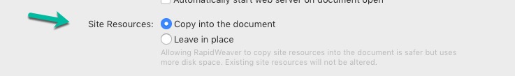

Check the project settings (advanced) is set to copy into document:
