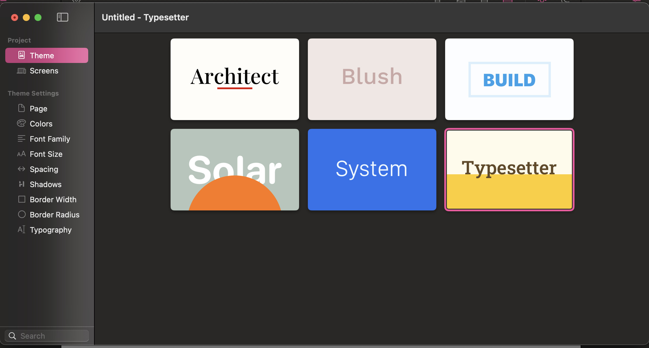

I started with an empty project and created a site structure and immediately regretted not creating a North Eleven-based project so that I could try out modifying a theme to style my pages.
In trying to solve this by moving my web structure into a new North Eleven project but that did not work. I also lacked a way of adding a template to my empty site and felt lost.
I guess my fear here is that I will paint myself into a corner by the way I start a new project or create pages. But I guess the new themes functionality and AddOns will be the way I can modify the look, feel and functionality of a Elements project going forward?

You can use the Theme Studio to make changes to the way your site looks, i.e. what colours and fonts it uses. This theme video is much older, but it will show you how the theme system works:

:grimacing: What theme update are you waiting for?
i think he is waiting for the fact that he can create his own theme-template under theme-settings which he can then save and use again and again …
