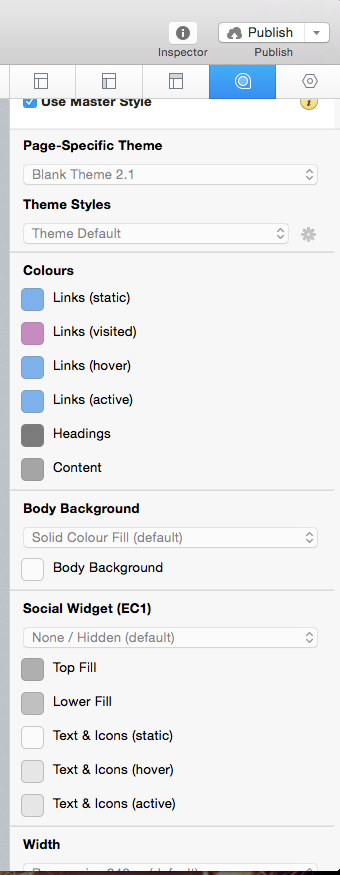

You should be able to change what links ‘look’ like in the inspector tab of your project, the theme you’re using will have some presets, but you can override these and then save your theme presets for future use. Un-tick the ‘Use Master Style’ box, then once you’re happy with everything you can click on the cog beside ‘Theme Styles’ and save it.
I got the impression that you only wished to do this for some links. The custom CSS is simple, something along the lines of a.alternative {font-style: normal; color: #ff2807;} a.alternative hover{font-style: normal; color: #87b2ff;} where “alternative” is the class name and “font-style: normal” prevents underlining. You could take the colour definitions from playing around inside RapidWeaver.
The trickier bit is applying those styles. You can use a stack such as Joe Workman’s HTML Enclosure to wrap a another stack in a div, in this case adding <div class="alternative"> before and </div> afterwards.
Peter, you are correct. I did only want to change some of the links. I changed my page layout based on your observation that there’s no use for a link that the viewer doesn’t know to click, and now I’m happy with my setup for my links. I will need to work on learning to apply custom CSS in RW.
