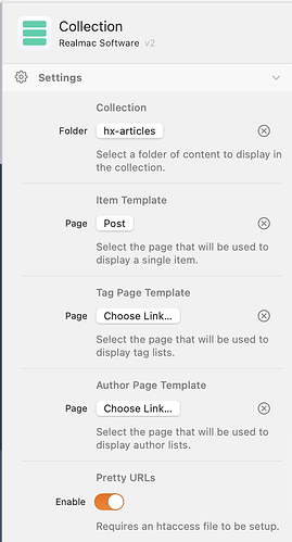

And here are the settings in the Collection component:

Hi @chet
I checked the development site and can see that the individual post pages are working with query parameters: Trusted Aircraft Brokerage & Sales | HX Aviation, LLC Copy Copy
The short version is: the rewrite rules don’t match the actual URL structure on your dev site.
On the dev site the CMS posts actually live at /hx/cms/post/{slug} not under /articles at all.
So the core issue is:
  • Your .htaccess rules are written to handle /articles/{slug}
  • But the real request path on the dev domain is /hx/cms/post/{slug}
  • Because Apache evaluates rewrite rules relative to where the .htaccess lives, none of the patterns ever match
  • Result: the rewrite never fires → 404
That’s why the query-string version works:
/hx/cms/post/?item=mastering-the-pre-purchase-inspection
but the “pretty” version does not.
To fix it, the rewrite scope and the actual CMS path need to line up — either by:
  • moving the .htaccess into /hx/cms/ and rewriting relative to post/, or
  • keeping it at the subdomain root and explicitly matching /hx/cms/post/{slug}
Once those match, the CMS handler will resolve the post correctly.
