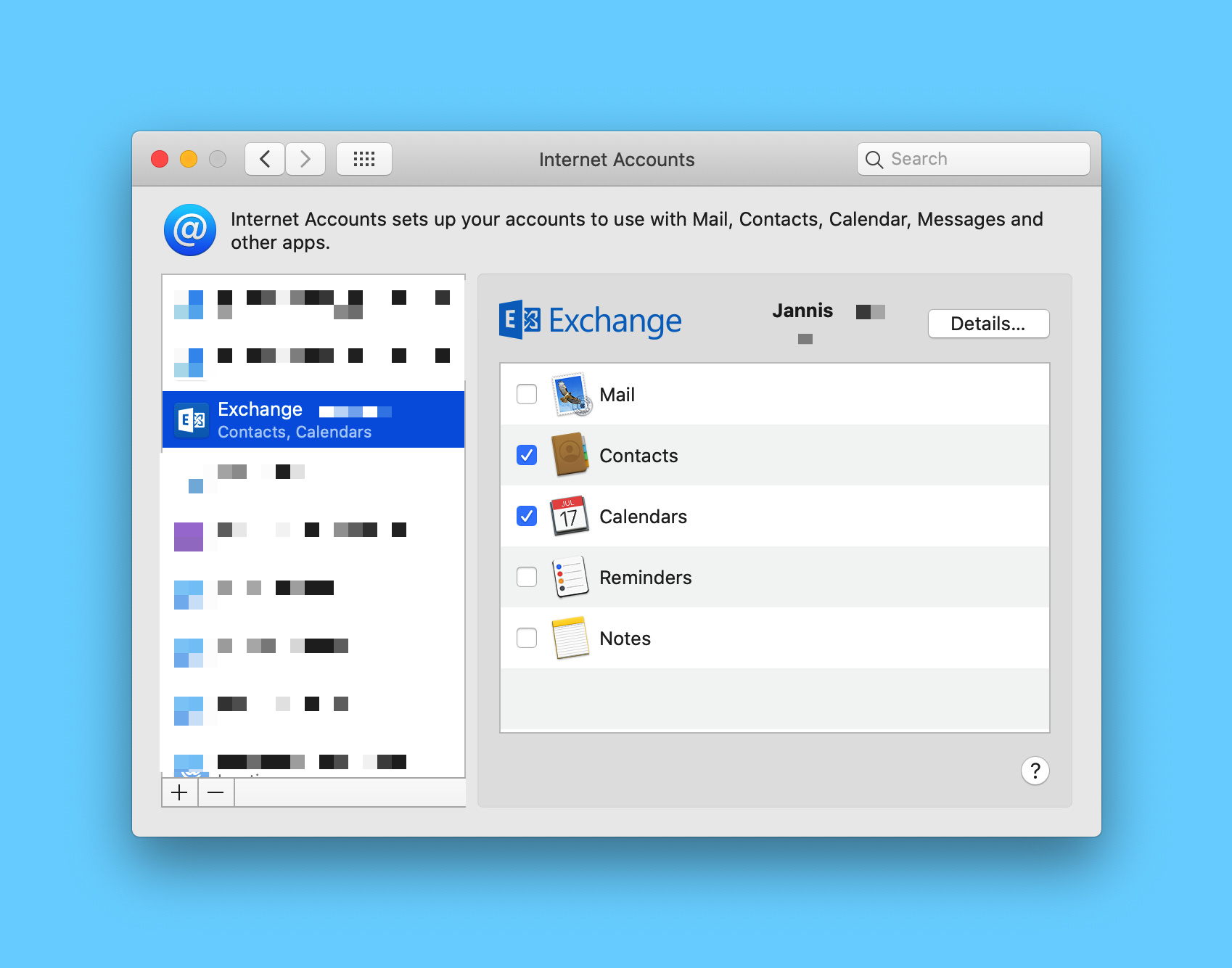

I am not using Apple Mail for the Exchange Mailbox. I am using Outlook for Mac.
With this, the process Accoundsd is not at all running.
Here is a screenshot of my settings. Try to use Outlook instead of Apple Mail, maybe this helps as workaround.
Yes, I can get that to work, but Outlook sucks and doesn’t integrate well with the mac eco system. It is a work around, so thank you, but I really would like it to work with Mail.app.
