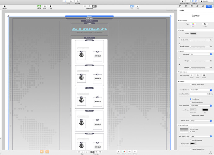

Try this…I used Foundation1…@joeworkman
http://www.ibize.com/stinger/
I laid it out 2 across so it didn’t need to scroll.
Hi Joe,
That is awesome! I would change some details here and there, but this is basically it!
But, uhhh, how did you do it? I can only see the published result, not your Stacks built up.
Thanks again,
Jim
Sample file…
