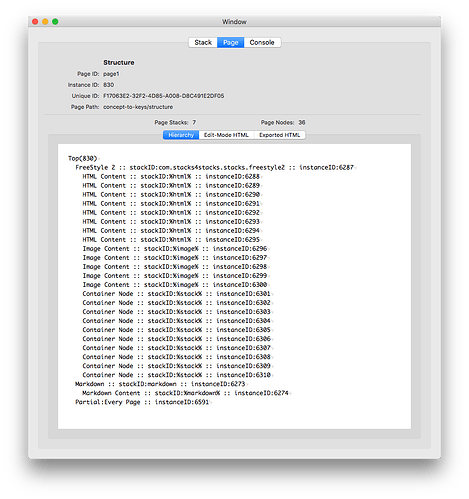

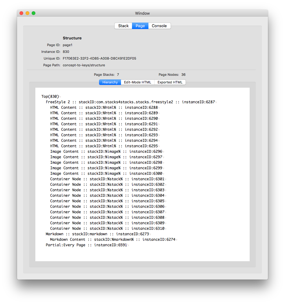

Site-wide, I’m not aware of a method to get a list of stacks used. However if you’re using Stacks 3 and enable the developer console (in Prefs > Advanced) when you open the console window you can get a detailed list of all the stacks and partials currently used on that page.
So as you can see in this example, 7 stacks are used in the page; including FreeStyle 2, HTML, Image and Markdown stacks, plus a partial named ‘Every Page’.
Open the console on each page, and you should be able to compose a list of everything used throughout a project.

Hi,
Just FYI, opening the Developer Console will also slow down Stacks because of all the extra information. Once you’re done using it, you should disable it and restart RW to prevent slowdown.
