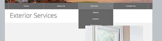

Hi, I’m curious how to fix this issue of my sub-menu being cutoff by a slideshow. A Preview screenshot is attached along with the edit mode view. You’ll see the ‘Maintenance’ title is cut off by/hidden behind the image
Almost certainly a Z-index issue with the menu. Increase the z-index value until the problem goes away. If the menu has that option of course. If it doesn’t then we’ll need a link to see it happening so we can prescribe something specific.

@kryten is correct. Its a z-index issue. MovingBox uses a high z-index when using the fade option. The following should fix it…
.top-bar-section .dropdown{
z-index:1999!important;

Aside from the vertically centering trick, this also fixed the sub-menu issue (without requiring Joe’s code). Thanks!
