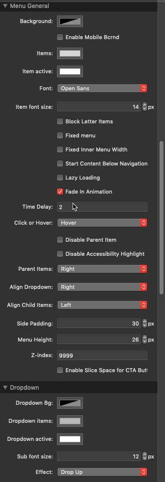

The navigation stack is only in a partial, which has no margin or padding. (attachment 1). The problem persists even without partial. I didn’t have this problem with other navigation stacks that came with foundation 6 or with Clean Menu (1LD).
Also see the settings I used in (Attachement 1,2,3)

Ok, I figured out how to stick the menu (“Fixed Menu” in Settings). I won’t need the Spider Stack and theres no top margin. Now I only need to center the text vertically.
Vertically center the menu items text?
Reduce the 18px top margin you have on the logo image (Brand Settings - Margin Top). With that padding and the size of the logo, you’re increasing the height of the menu area and the menu items are no longer centered. Alternatively, increase the Menu Height in Menu General.
Thanks! I just figured it out. decreased it to 5pixel. It’s centered now. Appreciate all the help!
