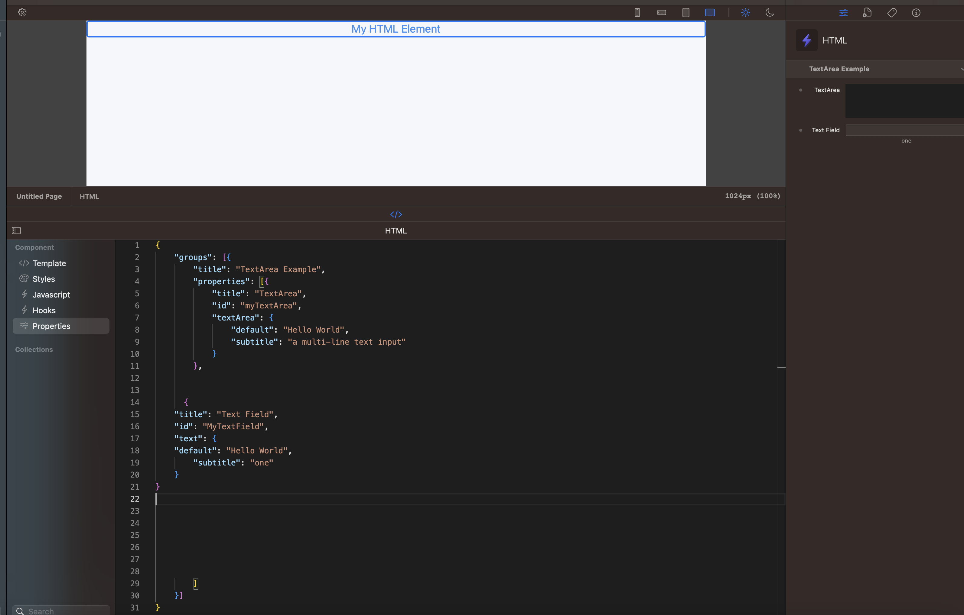

Text Area Property
@dan How does one instruct a textArea property to display more than one line?
Also the subtitle works for Text but not for Text Area
You can use the size property, like this
    "title": "TextArea",
    "id": "myTextArea",
    "textArea": {
        "size": 20,
        "default": "Hello World",
        "subtitle": "a multi-line text input"
Text area doesn’t support subtitle yet, but we may add this in the future. I’ll add a ticket for it.

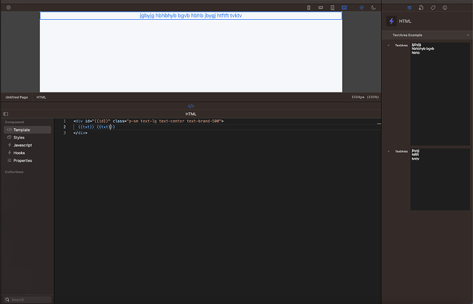

@tpbradley I noticed that when I set this, the actual area displayed in the inspector only goes to 4 lines; anything greater causes a scrollbar to become active in the text area. Is this the correct behavior?
That’s strange, do you have a simple example that reproduces it? This is how mine looks.
adding these lines displays text inline?
@tpbradley This is what mine looks like, I have the number of lines set to 10 in this case.
I’ll see if I can create a simpler test project to show off what I’m seeing.
Yes, you’ll need to pre-process new lines in a hooks file, replacing them with something like a <br> tag. Something like this should do it.
const transformHook = (rw) => {
    const { myTextArea } = rw.props;
    const processedText = myTextArea.replace(/\n/g, "<br>");
    rw.setProps({
        myTextArea : processedText
exports.transformHook = transformHook;
thanks that works
