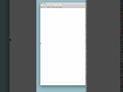

The oldest version of RW I have is 7.5, but try this.
  • Put your mouse cursor on the left-hand edge of the RW window until it turns into a tiny line with an arrow pointing to the right. It’s tricky, you have to be in just the right place.
  • Hold the left mouse button and move the mouse to the right and the page list should pop out
  • You can hide it by the reverse with the mouse pointer on the RH edge of the page list.
Just like this :slight_smile:
