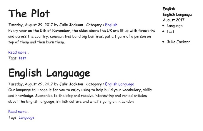

Now Iām really confused⦠everything you have in blue there is white on my screen and doesnāt show!
Sorry, I didnāt mean to confuse you.
That is just a screen shot of what happens when I add the css in my browser to test. It does not actually change your site, (only in my browser). I was just attempting to show you that the CSS I gave you above does work.
