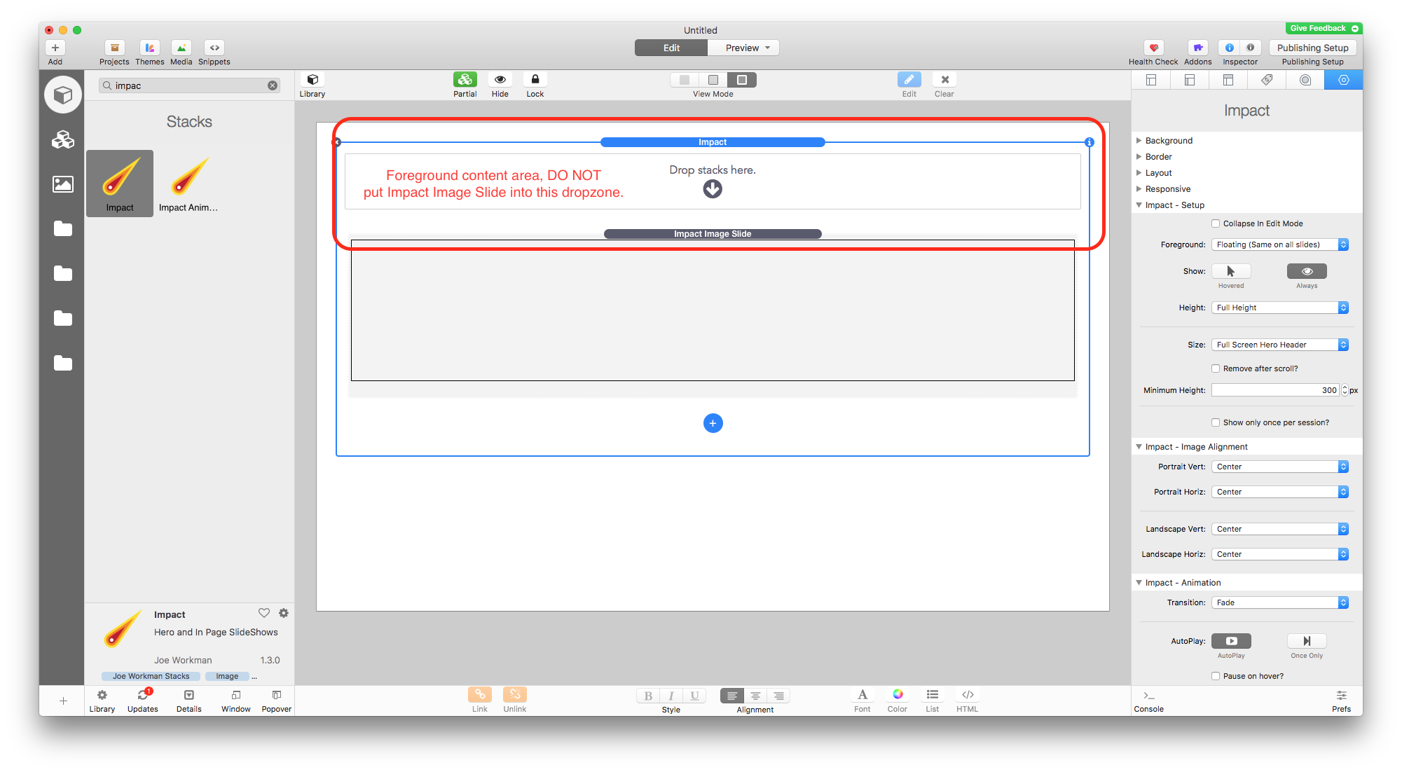

Looking closer, it looks like you have put the impact slide into the Foreground content dropzone, and it should not go in there. The Slides container is empty and your one impact slide is in fg-content
You can see here is what the page should look like with Foreground set to Floating (Same on all slides)
If you have the slides stack in that zone, take it out.

You do not need to use the code if you have the slide stack in the Foreground content area, which is the way it looks like you do.
