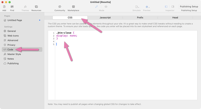

Hi @Sree ,
You could ask this on the Elixir support forums - Elixir is the publisher of Foundry. They currently accept feature requests for the next version of Foundry on GitHub (link ).
For now, you can hide the close button using some CSS.
.btn-close {
display: none;
Add that CSS here:

Hi Erwin,
I will try that, but I have close button on other stacks as well. So the code may affect that as well.
Regards
Hi @Sree ,
This code only affects buttons that have the .btn-close class.
Erwin
Sree
(Sreejith S)
July 11, 2024, 5:41pm
5
Hi
I applied the code to the button, and it worked.
Thanks.
