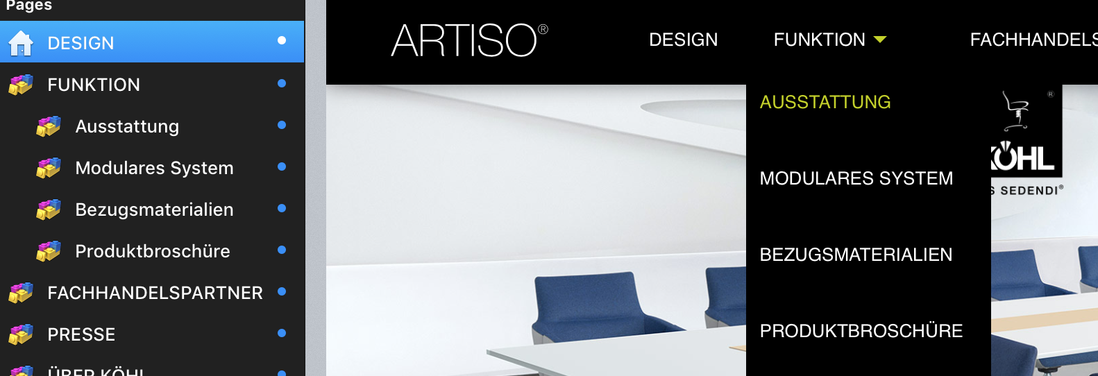

What I want is that AUSSTATTUNG in the submenu is going to the Anchor #Ausstattung.
Therefore I’m looking for a possibilitiy to edit the generated link which is done by RW/Foundation/Topbar

What I want is to make this submenue link AUSSTATTUNG going to an Anchor named #Ausstattung on the page FUNKTION. The folder of this page is named funktion.

I think what you are trying to do can be done but not by using TopBar with sub pages. If you add Ausstattung in RW as a normal page then TopBar is going to want to take you to that page not an anchor on the parent page.
You “Might” get away with it if Ausstattung is a page type of Offsite page (I’m not sure if that will work, but worth a go)
TopBar has other options under the Menu Settings in the UI. Right now you are using “Full Rapid Weaver Menu” I believe you are going to have to do it with either Magellan or Html for the menu Type setting in the TopBar UI.
Foundation also has a Magellan Navigation stack (may be in one of the add-on packs) I’ve not used it but I know it exists That may be an option as well.
