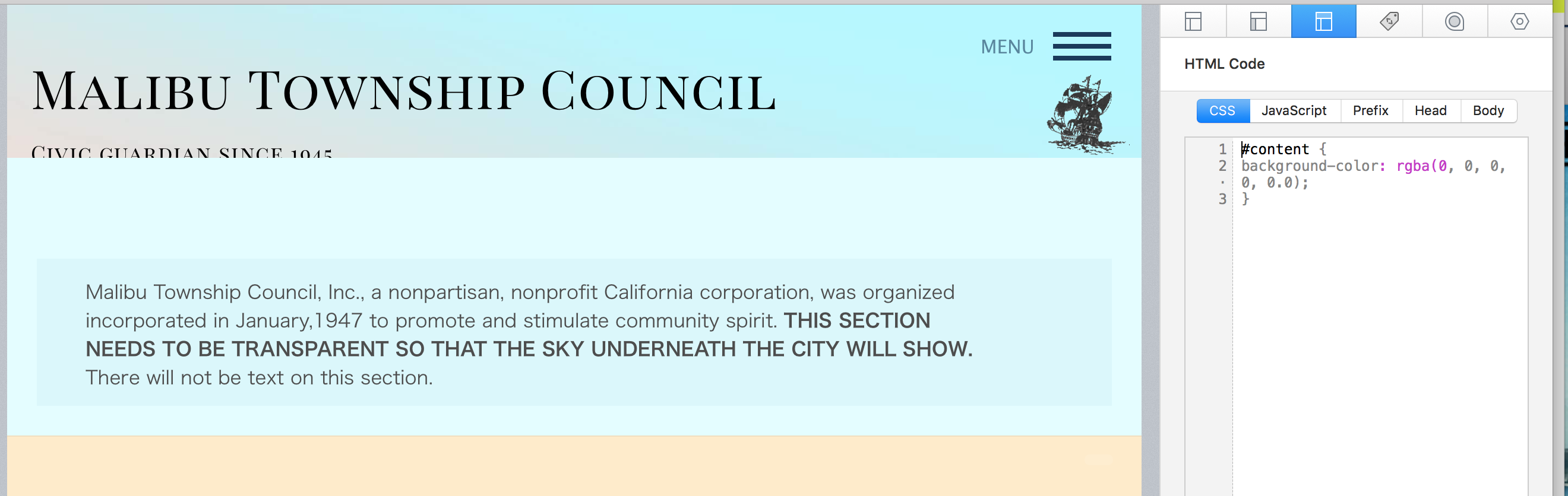

#content {
background-color: rgba(0, 0, 0, 0.0);
Hard to tell since things have changed.

For your instructions: (The screen-grab) Should I assume that I should put thiis code into the CSS box for Page 1?
I will try that now.
thank you.
The result is above. There is the page background, which should be transparent, and then there is a Production stack, into which I have inserted a text stack. I went to the stacks inspector and – since I could not get anything to be transparent – I colored them to match the sky on top. The Extra Content 2/footer section below that was colored to match the portion of the sky that was behind the hills and matching the horizon. And yes, I altered the photo a bit – I could bring back the all-blue sky since I still have the art for it, but my aim is to get a transparent text container so that this appears to be letters over the sky and showing the full gradient of the sky.
I don’t think that those instructions worked . . . maybe I did something wrong. I included the stacks inspector at right.

you can add opacy = 0 to the background and also the the white sharing
the DIV is #extraContainer3box_color + #shading
put this cose in the sidebar HTMLcode/CSS
/* remove flat color */
#extraContainer3box_color{
opacity: 0;
border-top-width: 0px;
border-top-style: none;
/* remove gradient */
#shading {
background-image: none !important;
if you need help drop me email
infoATmultithemes.com
hope this helps

Ann, check you mail with the new code
