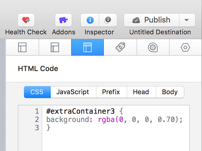

I don’t have access to the Gamma theme and can’t see a free demo version for it. But the normal procedure would be to use custom CSS code (entered in either the sitewide or page inspector Custom CSS boxes) combined with a background property and RGBa:
#extraContainer3 {
background: rgba(0, 0, 0, 0.70);
You can use an online generator like this, to preview and get the RGBa colour value:

I decided to try all your suggestions one at a time. I started with Will’s. Maybe I’m doing something wrong, Will, but I tried what you suggested, and it didn’t work. Maybe I’m entering the CSS code in the wrong place. I copied what you suggested and put it here. In the bottom image you will see why I need the content boxes to be clear.
This is why I need it:
You can see the faint line separating Extra Content 3 from the page background (which needs to be clear, also as the sky has a gradient in it and I don’t want to have to match that and transfer it into the page background as a “color.” Then also, there is a color differentiation between the EC3 and the photo. If I could just LOSE the EC3 altogether, I’d prefer that. I will try the next idea now, but maybe, Will, I’m doing something wrong so will come back to it if so.
I also tried it using the words “extracontent3” and I tried it with other numbers, too, in case I was confused on exactly WHICH extra content it was.
Don’t know why the letters and first 0 turned to the color magenta.
By the way, that CSS color code generator is VERY COOL!

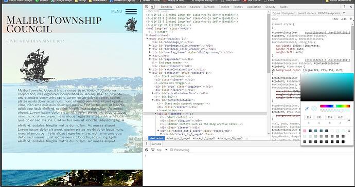

I don’t have the Gamma theme but there must be a way to get those boxes transparent. If you look in the browser inspector, it is easily done. CSS edits are not my speciality however. Will’s original suggestion should be close, it’d just be a matter of changing the class name I think??
On a side note, if you think the audience/client is going to be very picky, it might be worth switching to a free-form theme now. You could use Gamma as the ‘inspiration’ to try and design to, which would at least give you direction…
@jabostick is correct, you can do it by over-riding the CSS but you need to set the background-color: rgba(0,0,0,0) (or whatever tint you want, not just color:…

I see all of the code that you wrote in the image above. Where to I put that in my RW theme edit section? I know I seem completely ignorant and dumb, but RapidWeaver is a good place for computer-ignorant people who are good at design to LEARN these things! I used to lay out pages and write for magazines and newspapers – back in the day. But, times have changed. Ya gotta adapt. But as you move forward in life, the opportunities to do that seem to dwindle, so RW is perfect and this community of helpers is THE VERY BEST!!!

That is done by viewing the Developer Tools in your browser. Each browser is a tiny bit different but if you right-click on something, click ‘Inspect’, you can view those. None of the changes you make will save, it’s just for testing/previewing purposes, but you can play around with the settings.
Unfortunately, I don’t quite have the knowledge/skills to turn my screenshot into CSS code, but it does help me better understand how my site is designed or other troubleshooting.

Depending if you want it to be for the entire site or just a single page, the code goes either in the CSS section of the page or site-wide CSS.
