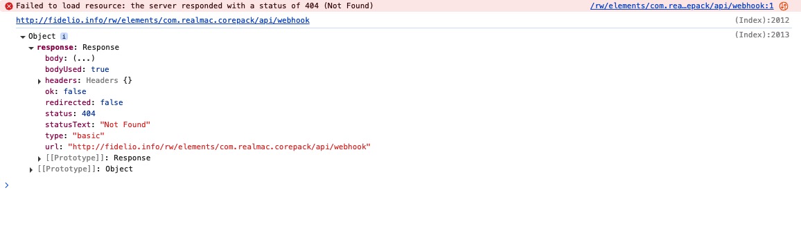

Hi Ben,
I have exactly the same problem. Instead of email, I use webhooks, which send the data to zepier.com and then enter it into a Google Sheet. This works perfectly on the zepier site. In the contact form, I always get a 404 error. I have checked the .HTACCESS file.

What could be the problem?
Thanks a lot…!
Tony
