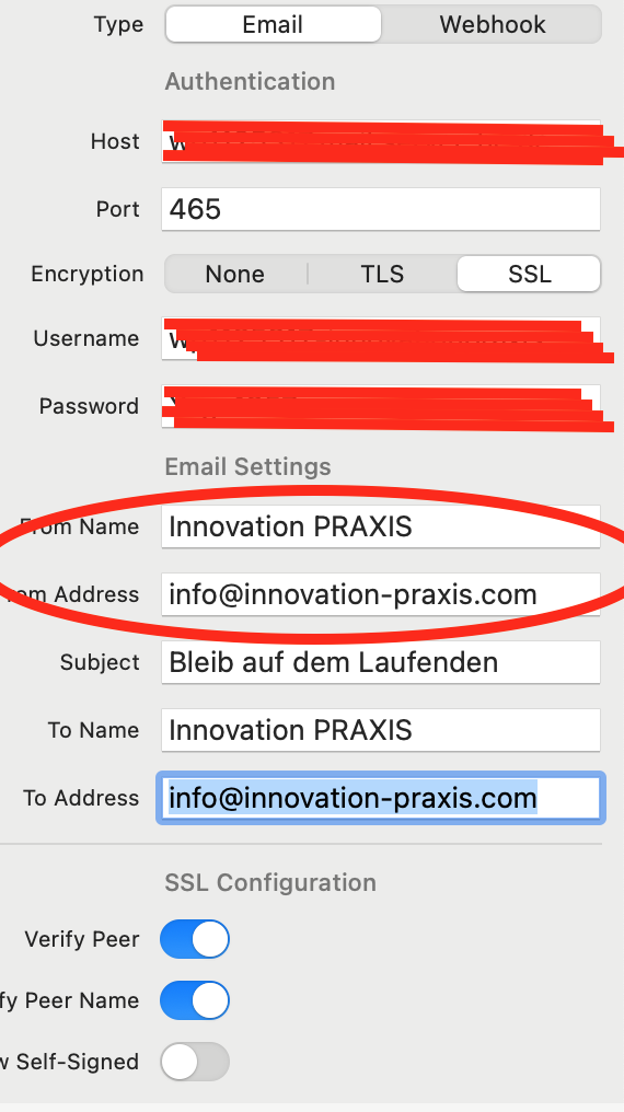

Here is one thing in the Form setting, that I don’t understand:
Isn’t it so, that the sender put in his own address? Why I should put in my address???

Hi @Gelbseidenraupe
You need to use your own email address as the “From” address because the mail server will only send messages that come from an address it recognises.
If we used the visitor’s email there, the message might get blocked. The usual way around this is to keep your own address as the sender, and then set the visitor’s email as the Reply-To.
That way the form email always gets delivered, and when you hit reply it goes straight back to them — this is how Forms work in Elements.

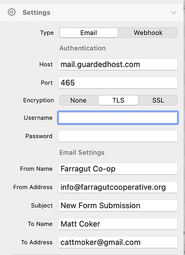

I’m having the same problem… I’ve placed the Submit button in the Form Wrapper but it doesn’t work, nothing happens, even when the site is published and all other variables checked. Contact Farragut Homeschool Co-op Knoxville TN

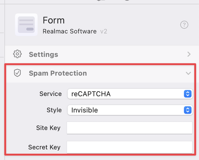

This one looks like an incorrectly configured reCaptcha.
I inspected the browser’s error console logs and am seeing:
Error: Invalid reCAPTCHA client id:
This suggests you have reCaptcha set as the spam protection method for the Form, but the client id is empty or incorrect.
When submitting the Form the request returns an error of
Spam protection provider ‘recaptcha’ is not properly configured
Please check the Spam Protection settings on the Form component and try again :slight_smile:

Your server is returning a 504 error - which is a “timeout error”. This means nothing is being returned from the request to the backend PHP code. My first guess is that the mail server you are trying to send through is not returning a response for some reason — it could be an incorrect setting such as the server name, port, username, etc. being incorrect.
Have you gone through all the steps on our Form checklist docs?

Thanks @ben , I did, @elementsbot confirmed correct settings and as far as I know Little Oak Hosting said it’s correct on their end too… but maybe I need to check with them again. Anything jumping out at you?
Nothing happens on TSL or SSL btw.

  • Host, Port, Encryption, Username, Password — all must be provided and correct. Double-check with your hosting provider that:
    • The SMTP host and port are right for OUTGOING mail. (Sometimes email clients and web forms want different ports/settings!)
    • “mail.guardedhost.com” uses port 465 with SSL. (Some hosts want 587/TLS.)
  • From Address should match an email actually hosted on that server and with SMTP/IMAP access. Sometimes, using a different domain (e.g. sending “from” a Gmail-address on a non-Gmail host) will just… not work.
  • If you see a 504 timeout, that’s often a firewall, wrong mail host/port, or network timeout. Worth checking server logs or asking your host for any mail blocks.

3. Spam Protection Setup
Here’s how to set that up in the Form component:
  • Service: Choose reCAPTCHA, Simple, or (if you’re brave) None.
    • :white_check_mark: reCAPTCHA: You need to enter your Google reCAPTCHA Site Key and Secret Key. Get them here.
    • :white_check_mark: Style: “Invisible” is fine, or switch to a visible one if desired.
  • Tip: If you pick reCAPTCHA and don’t fill in the keys, you’ll get errors like “Spam protection provider ‘recaptcha’ is not properly configured.”
  • If you want to keep it simple (and make sure this isn’t the problem), set Service to None, and try again.
Here’s the relevant section from the Elements Manual - Form Component:
The “Spam Protection” panel allows you to select between “Simple” (math test), “reCAPTCHA” (Google’s service), or “None” (not recommended for production sites).
