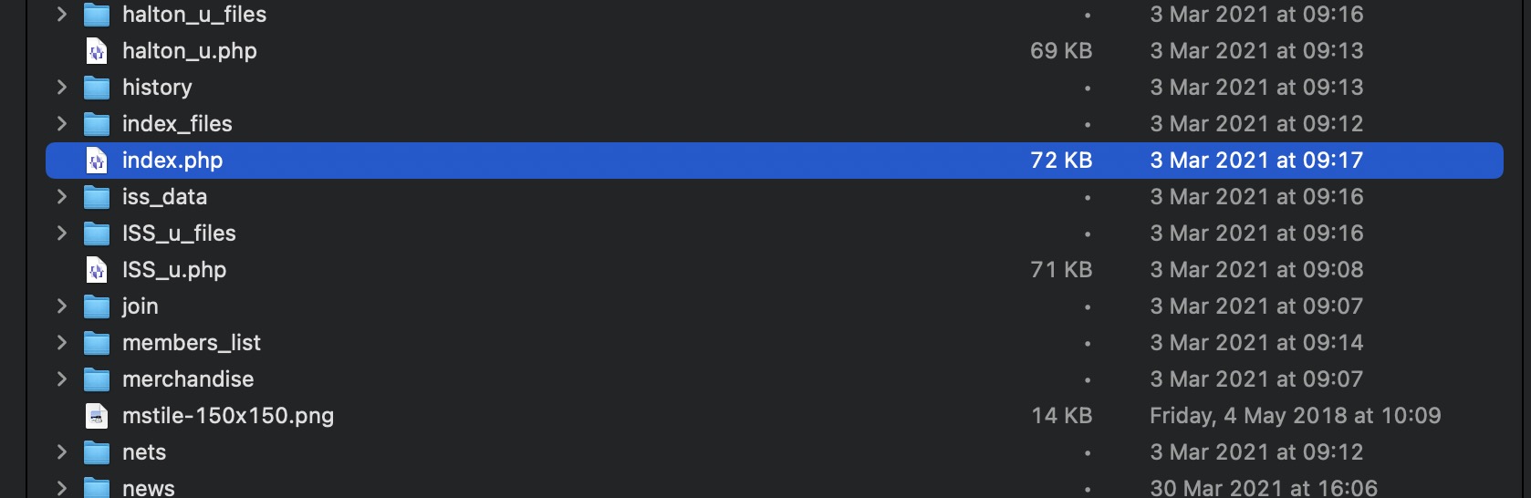

If you home page is index.html or index.php and it is in the root directory, then the files for your home page will by in the /index_files directory
See here where my page is /nets/index.php the page contents are in /nets/index_files.

Your home page will be a file, not a folder in the roots level of the folder you exported into. It will be called index.html or index.php.

I was surprised to discover that the contents of the homepage are shoehorned into the index.php file. But skimming through 5115 lines of its code convinced me that it was all there, so (after backing up the existing index.php on the server) I uploaded a revised version using cPanel, and lo and behold, the revised version appears on the site. With that I proved I can incrementally update individual pages. So this ‘back-door publishing’ method looks like it will work for me.
