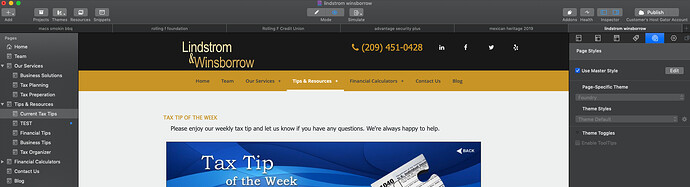

https://landwaccounting.com/tax-tips-and-resources/test/ is a blank html theme, with Offsite and text with the link that the iframe is supposed to show.
Tax Tips | Lindstrom Accounting, Stockton, CA is a Foundry page.

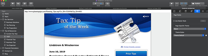

I set up a blank HTML page with no stacks. https://landwaccounting.com/tax-tips-and-resources/testhtml/
