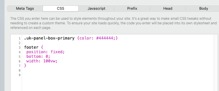

Hello,
Can someone help me with a jumping footer.
It happens when I place a stack into RW, when I take it out, the footer is along the bottom, where it should be.

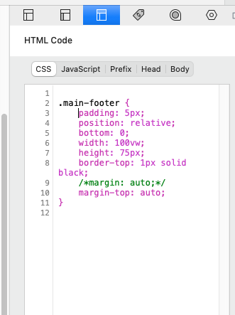

I am trying remedy the problem with css code. If one of the codes below is okay, where should it go please?

You’ve already put the code in the correct place by the looks of it. Assuming that your footer indeed has the class “main-footer”, it will target your footer and set the margin for the top to ‘auto’ and the position to “relative” (along with everything else you’ve defined, but those do not relate to the positioning).
However, “position:relative” will likely not give the effect you’re looking for (unless I misunderstand your question). You actually want to force the footer down to the bottom of the document (not the viewport, which is you visitor’s browser window, but the document).
You could put all the other contents on your page in a container and class that as “page-content” (for example) and leave the footer out of that container. Then set the CSS to have “page-content” fill out all the white space below by using a flexbox:
