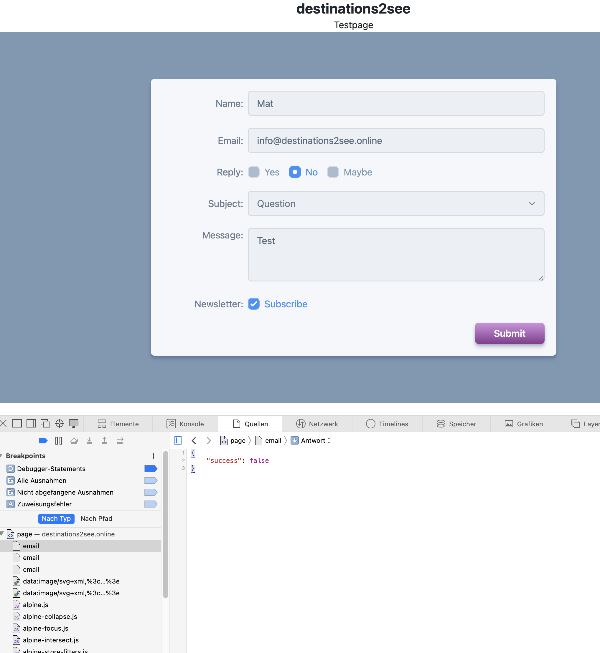

I just wanted to clarify that the error messages I’ve mentioned before are not coming from the components. I see them in the inspector of my browser:

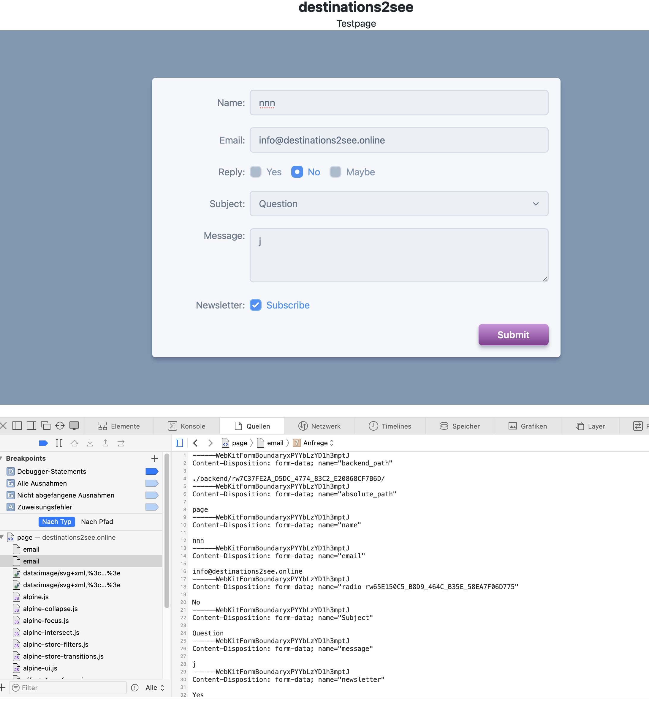

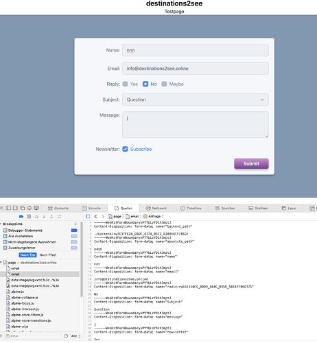

At least the data collection from the form seems to work, but apart from that - still stuck.

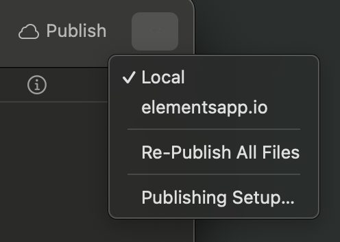

Try to republish your entire project. I’ve noticed that a lot of new PHP Files are published to the server once you do that. Afterwards, you don’t get this error (although it’s still not working for some other reason)

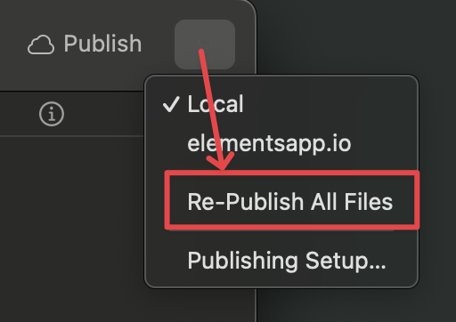

could you try a “Re-Publish All Files”?

for those following along and having issues with the Form - could you try a “Re-Publish All Files” to ensure everything has been published to your server.

I wiped the whole site, renamed the site of the Mailform and performed the “Re-Publish All Files” from the upper left corner of Elements. However, there were only approx. 72 files uploaded. The API folder that @RussOggi255 mentioned earlier was not there.
Then, I performed “publish current page” from the “File” menu, and there were approx. 680 files uploaded (many PHP). Apparently “Re-Publish All Files” does not work correctly. By the way, I have already noticed this with previous mistakes. But unfortunately, the mail form still doesn’t work. New URL is here:

If I remove the API-Folder, at least the error-component works.
If the API folder is on the server, the error-component doesn’t work (pushing the submit button leads to no visible reaction on the website)
