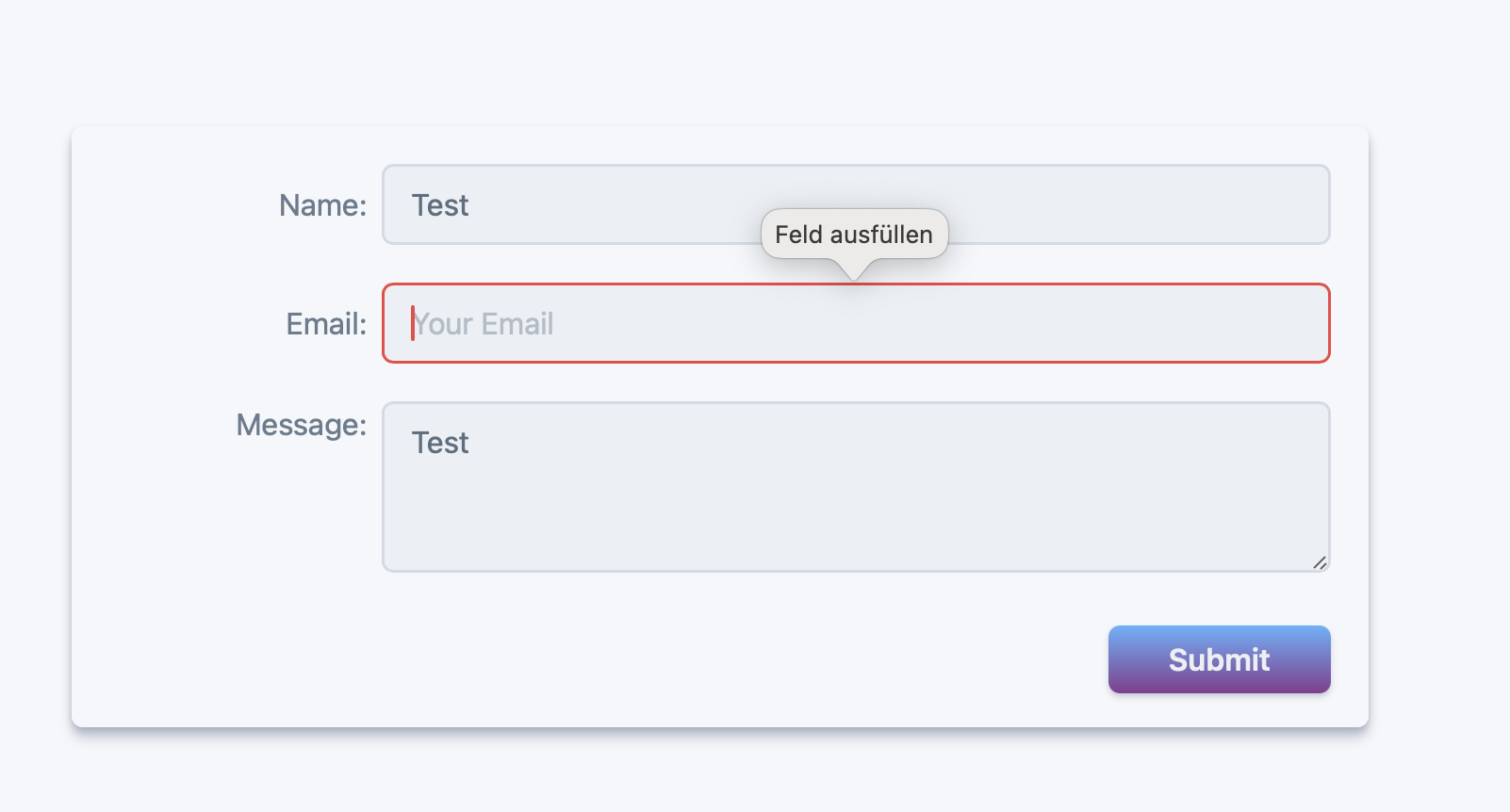

@ben : I think that the field validation is also a huge pitfall. If I leave the mail field empty, an error pops up, which is good,
But if I enter “a@b.com”, and then submit, nothing happens. No error message at all, but also no processing.
I added these two components to the form to do my testing. I also removed the attachment component as I wanted to keep it simple. But none of this made any difference, the form was never successfully sent.
