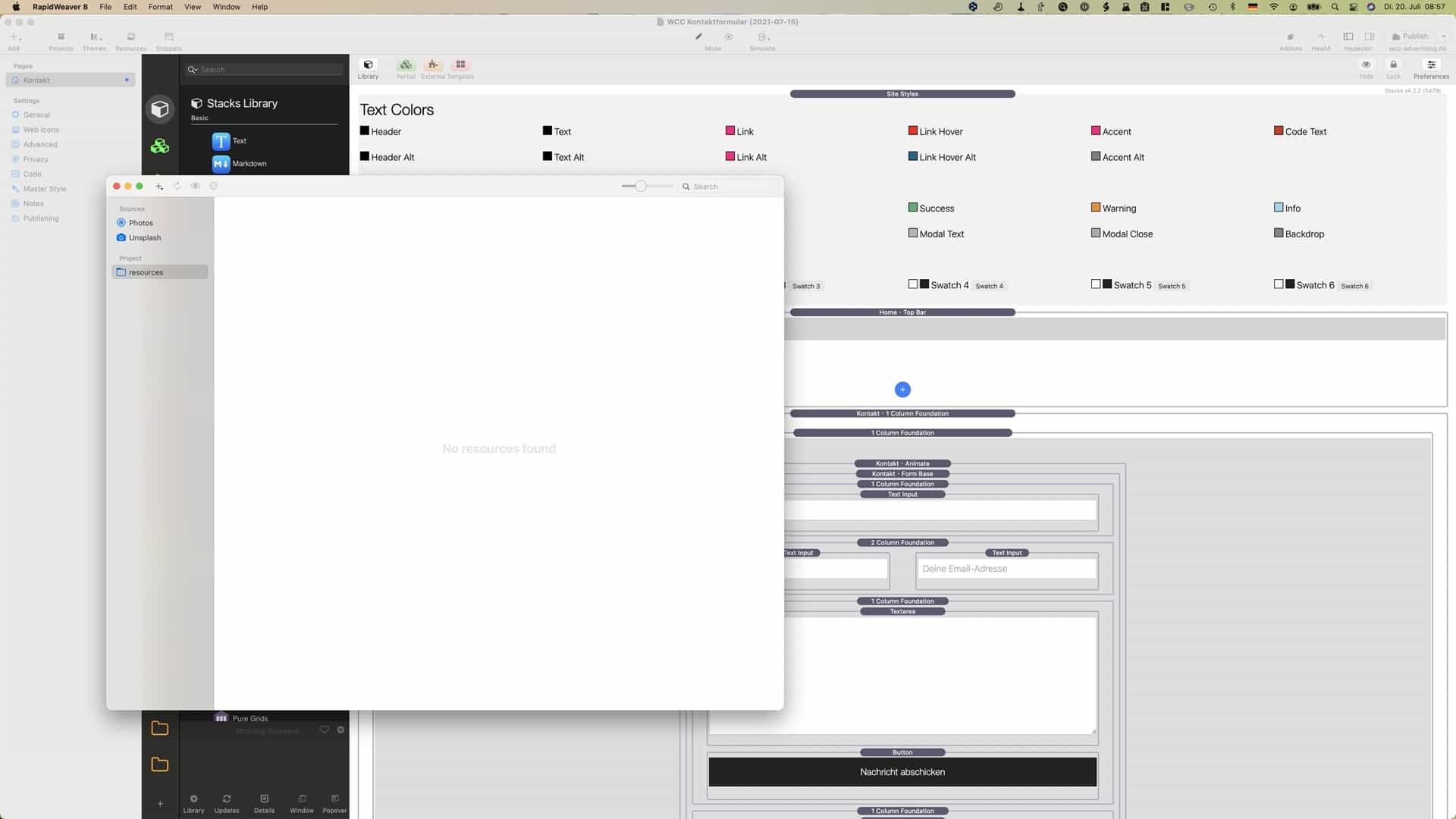

I often have the problem that resources I had deleted from the resources folder remain in the depths of the project file. Here is an example:
The resources folder seems to be empty, but in the depths of the project file the resources I have deleted before remain and inflate the size of the project file (and maybe still interfere with some functions). This project file has a size of nearly 900 MB, but actually it should not be much bigger than about 100 MB.
