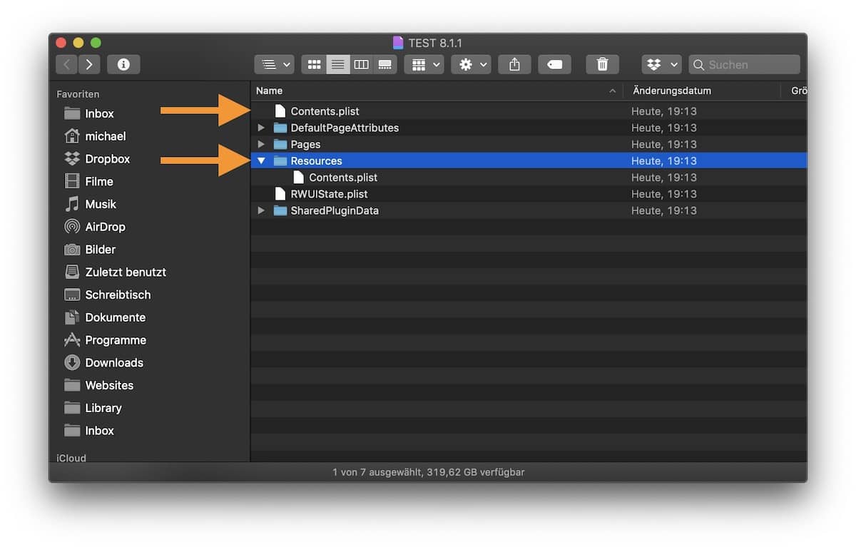

@tpbradley I just downloaded RapidWeaver 8.1.1 and tried it on a test project. The project is an existing project, which I created with RapidWeaver 8.0.3. I have deleted all pages and resources from the project except the start page, as well as the publishing settings, the web icons, etc. In the remaining start page I deleted all stacks, so it’s an empty project.

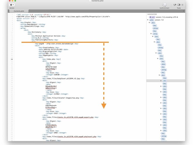

Under 8.1. we had the error that a bunch of empty resource folders remained in the directory /Resources/ of the project package. Furthermore, there were many entries in the content.plist that referred to already deleted stacks, but also to other data (lines 16 to 13000).
With 8.1.1 the first problem is solved now, the Resources folder is empty. The second problem persists
Great news that 8.1.1 is helping! What you’re seeing in the plist file is publishing manifests, it records information about where files have been published. RapidWeaver doesn’t typically remove this information from the project because it’s still useful.
For example, you may have removed a resource from a project but it will still exist on your hosting server.
O.K. - I must accept your explanation, even if I cannot fully understand the meaning behind it. Why do links and configuration data that are no longer needed have to be retained in a plist?
We retain it because it may be needed in the future. A perfect example of this is if you accidentally remove a publishing destination then re-add it a few days later. It would be really annoying if you had to re-upload a big site because the publishing data was cleaned out.
In reality this data is tiny and doesn’t cause problems, so it’s safer to keep it
