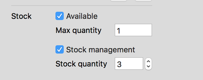

old thread, but I had same problem and found this thread.
My issue was I had stock management enabled, but the max quantity was set to “0”. Looks like this option sets the maximum QTY a person can add to cart (this is not stock management). So with it set to zero, you I would get the LIMIT error. Just set it to more than 1 and now works.
