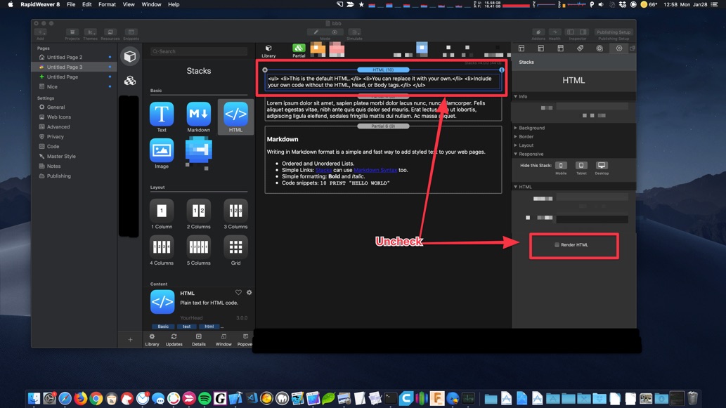

The source of the scrolling issue happens when the rendering of the stacks layout area is confused (also when it is very very very slow – but that’s for a different thread :smiley: ) .
In your case it sounds like there was some copy-and-pasted content. I suspect that’s the fly in the ointment.
In one respect this odd behavior is a good early warning system. If it’s causing Stacks to have issues, then it will also cause your published page to have issues (probably NOT scrolling issues though).
You can, however, “disarm” this HTML – this is especially useful when there is an HTML bug in your code that is causing more serious rendering issues.
Try this:
  1. Add an HTML stack
    Always paste code (HTML, CSS, JS, PHP, etc.) into an HTML stack. Pasting code into Styled Text is possible, but requires a lot more work. Avoid that if you can.
  2. BEFORE you paste
    Select the HTML stack and open the Info Sidebar. Scroll all the way to the bottom, the very last setting is the one we’re interested in.
  3. Uncheck the Render HTML checkbox
    See the screenshot below.
Unchecking the box will disarm most bad HTML content and at least let you keep working on it.
However a warning: this will allow you to edit that bad content – but it will still be bad content. And if you publish your page with that bad content, then your visitors will see those problems too.
Also: If you really can’t figure out what is causing the issue, send us a the code here and we’ll see if we can help spot the problem. Happy bug hunting! :smiley:
