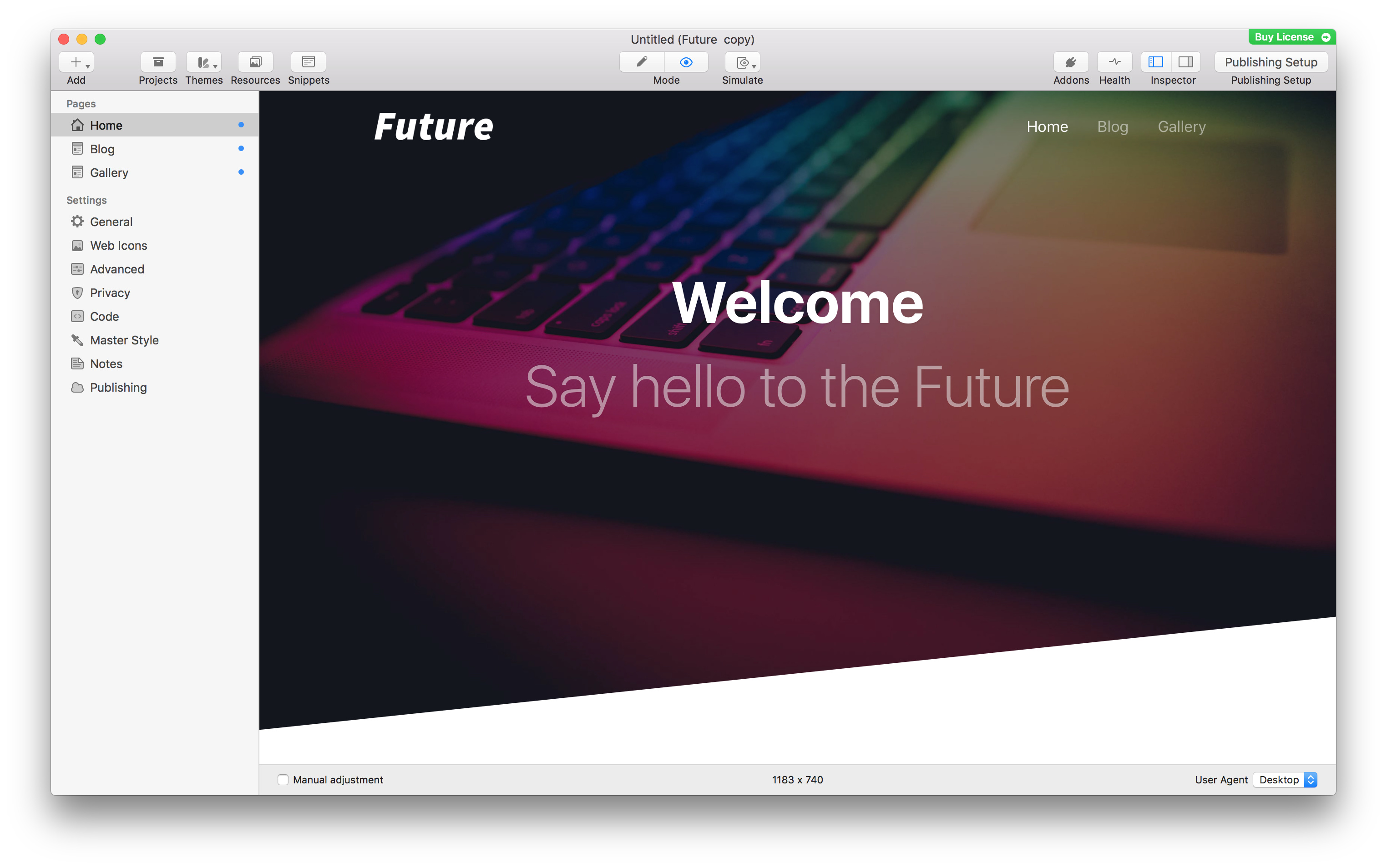

Try this:
  1. Create a new document using the Future theme.
  2. Click on the eye icon to go into Preview mode.
  3. Click on the Simulate button and set to iPad (or iPhone even)
  4. Scroll through the page until you see that there is a transparent section which allow elements that are meant to be hidden to be seen.
That’s a very basic use of RW, and it should work perfectly. I found other similar problems in other themes. Thinking it could be a problem with the device simulation I tried exporting and uploading to the web to test with a real iPad and iPhone but there were still problems.
I did some testing and the Artful theme appears to work perfectly, whereas none of the others did. None. This means it is actually almost entirely unusable. RW is meant to be a solution to easily publish websites without the user having to fiddle around with design elements or fix any problems.
Based on this, I’ve had to discount it as an option for the project I have in mind. I’m posting here because this needs to be fixed, for the benefit of RW, not for me. I’m a person who likes Rapidweaver based on my history with it, so I’d give it more time than most and come here to share my experience. Anyone else who demos this in its current state is just going to drag it to the trash and never return.
Any chance of a screenshot to illustrate what you mean in Step 4? I don’t quite get it.
I don’t understand either. What kind of page are you starting with, a Styled Text Page? And are you putting anything on it? As robbeattie says… screenshot please.
One at a time because I’m a new user and I can only upload one at a time apparently.
What you see above is literally all I am doing. No editing, nothing.
What happens when you take the image out and preview it in the simulator?

I understand that you’ve gotten to the point where you don’t want to pursue this any further. That said, I just took a few minutes and recreated your example, and I’m not seeing any display issues either.
That’s three users now who have tried to recreate your issue and have not be able to. We’re not doubting you’re having an issue, but it’s not an issue we’ve seen before. That’s why we’ve taken the time to check things out.
