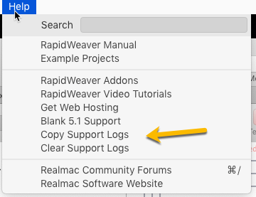

You can also clear and copy the support logs from the Help menu item.
I’d suggest you clear them first and then make the crash happen, then copy them and send them to the email address above. I’d put a link back to this thread, and maybe tag here when you are done.
2021-08-06_10-33-51
Thanks, this was great info. Using that log, I can see what is the issue. Seems that the S3 publishing works only in us-west-1 region.

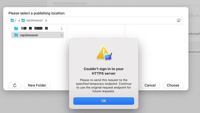

What happens if you go to the publishing settings and try to browse the path or test the connection? I am getting this error, regardless of the selected region, also in us west.
When creating a bucket, I have to wait about 30 min to be able to use it in RW. If I try to use it too soon, I get that error about temporary endpoint.
