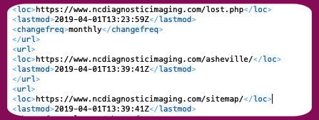

I’ve deleted the sitemap using FTP to be sure a new copy is being generated, but it continues to show up when Sitemap 2 is republished. Screenshot below is just prior to manually deleting the page in question (Asheville)…

To remove it from the XML file you check the Disable Search Engines box. It seems like you have the right thing.
“Hide in Sitemap” removes it from the the table of contents style site-map page – the one that users can see.
I think the first question I have is what version are you running. There are some significant incompatibilities with the older versions of SiteMap and the most recent versions of RapidWeaver.

Open the Settings and in the first tab, near the bottom, select the option that says “Hide page marked with ‘Don’t Show’”
I suspect that (in combination with your other settings) should make the checked items disappear from the XML file. I did that and it seemed to do the trick for me with the example that you sent (and thanks – that made the issue crystal clear).
