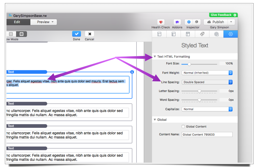

Often overlooked, are the text formatting option that come with every text stack by default. When text is selected you have a new set of options to the right →
