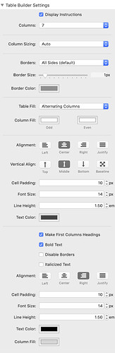

These stacks work much the same as any other stacks you would download and use.
In edit mode, you can access the settings for both stacks in the Stacks side panel.
Table Builder:
Super Tooltips:
Note how in both stacks, the first checkbox option allows you to toggle the display of instructions.
And in the settings for Super Tooltips, you can clearly see the select menu option there to change the theme, which you asked about in your last reply.
So if you did not know how to use Super Tooltips, you would move your mouse over the setting that says Display Instructions and click once to enable that option (mark it as checked or clicked). Then in edit mode you see the instructions for the stack.
To turn off the display of instructions after you have read them, uncheck the Display Instructions setting.
