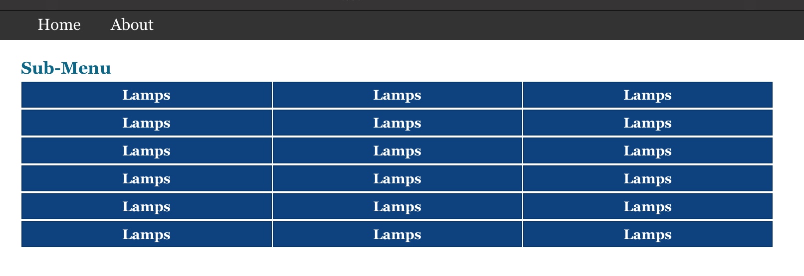

What do think about something like this:
The sub-menu button reveals the buttons.
Live sample:http://www.ibize.com/test1/
