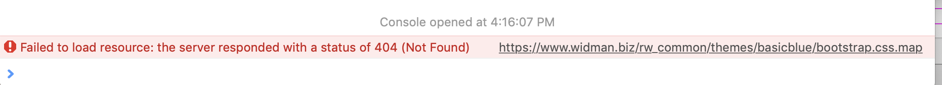

Looking at the page source on the web, I saw this message
so I went to the ThemeFlood site and downloaded the latest version of the theme, re-published everything, but still get the same error message.
