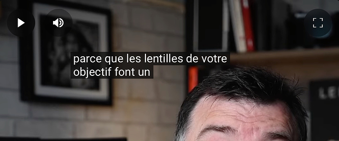

Yes, this is the way I would like it works. If AI can help us, so why not.
For some french speaking youtube videos, I get automatically the text in french (see the picture here after), so I wonder how it works. I don’t think subtitles are generated in the same language for a spoken language (this is done for DVDs with tracks for the hearing impaired). And if it works for the same language, why not for another one?
I’m using FCPX for my videos and and know that generating subtitle tracks is a lengthy process.
Zdenek

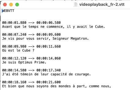

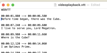

What you can do, is have your video transcribed by AI. This service, for example, does this. You’ll end up with a (French in your case) transcription of the video.
Next, you’d turn that in to a French language VTT file. This service does this.
You’ll end up with a .vtt file that looks like this:
You can use ChatGPT to generate translations of the file into the languages you’ll need for your website. You’ll end up with a bunch of files, one for each language.
Using the code snippet in one of my previous posts, you can now have the subtitles loaded automatically based on the visitor’s browser settings for language.

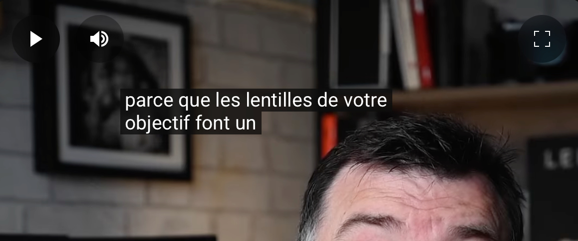

OK, it works. However, I realised that the automatically generated text is often misaligned with the image. You can choose the number of words per line, which sometimes truncates the text in a strange way.
In fact, you can’t replace human intelligence with algorithms. :thinking:
If I want the two to match up well, I go back into FCPX and adjust the words manually. It takes more time, but it’s more appropriate.
I don’t know if you also work with these tools, but if so, I’d be happy to hear about your experience.
