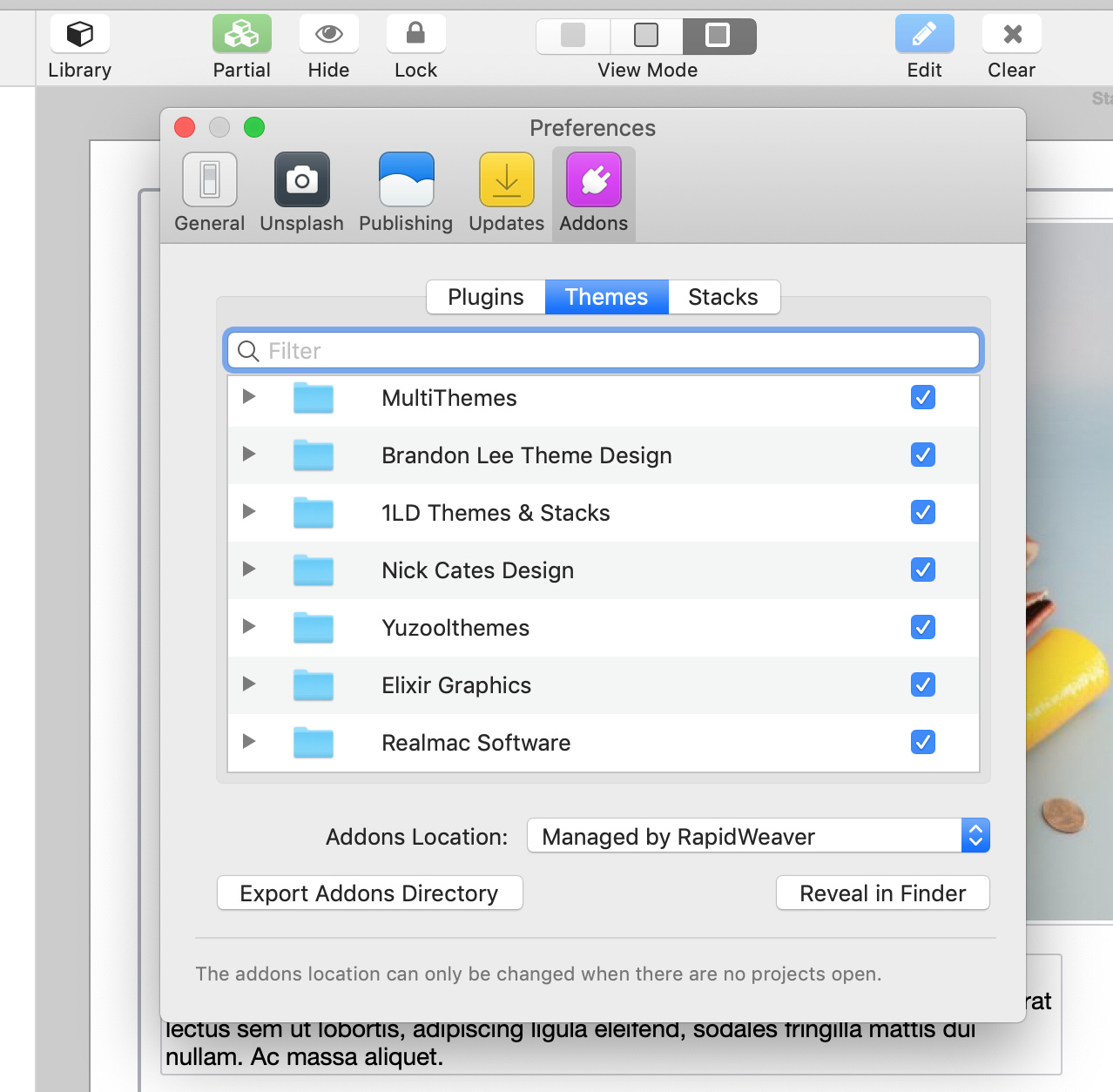

I’ve verified that i only have one rapidweaver application in Applications.
(screen omitted)
In Themes, I have no Foundry.
(screen omitted)
I click the foundry theme in my downloads, and get the install screen, I click install
(screen omitted)
I get warning message that install is older or same - which seems to indicate i have the theme already installed??
(screen omitted)
I hit continue, install addon window prompts to relaunch RW:
(screen omitted)
Prompt to save, I click save
(screen omitted)
I relaunch RW, no Foundry theme…

I had to cut out all the other screen captures as the forum said i can only post 1 -
