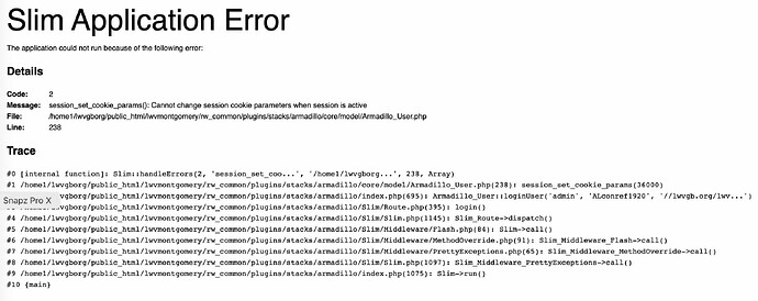

I am getting the “Slim Application Error” shown in the attached screenshot when attempting to login to the Armadillo dashboard accessed at https://lwvmontgomery.org. It says “Cannot change session cookie parameters when session is active”. Any help with this problem would be appreciated. @willwood, your thoughts? I am using RapidWeaver v8.3, Stacks v4.0.3, and Armadillo v2.8.0, and Armadillo Solo Content v1.2.0. Thanks in advance.

The error seems to vaguely suggest a session cookie cannot be created, to confirm you are logged in to the system.
Perhaps a PHP update on your server means the version of Slim used by Armadillo in incompatible?
See if there is already a newer version of Armadillo to download.
Try a different web browser, on the off-chance the one you are using is having problems with setting cookies.
If problems persist, it would probably be better to reach out directly to the add-on developer @nimblehost
Hi Jean,
This particular error was fixed back in v2.9.0, please do check for updates and install the latest version (v2.9.4 as of 10/3/2019). Once you’ve installed the latest update, you’ll also need to re-publish your site from RW.
Hope this helps.
