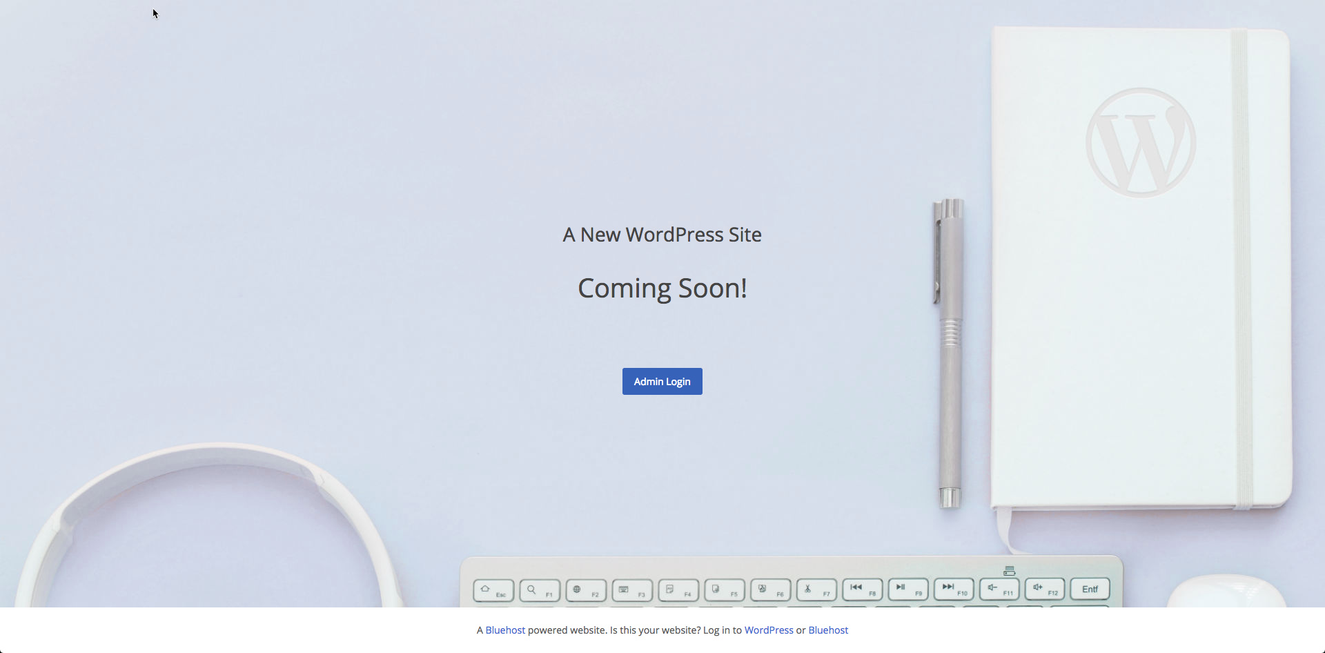

I get the same error from both pages using Inspector in Chrome and it’s trying to load a PNG which seems to be a WordPress holding page. Ring any bells?
Looks like the attached.
