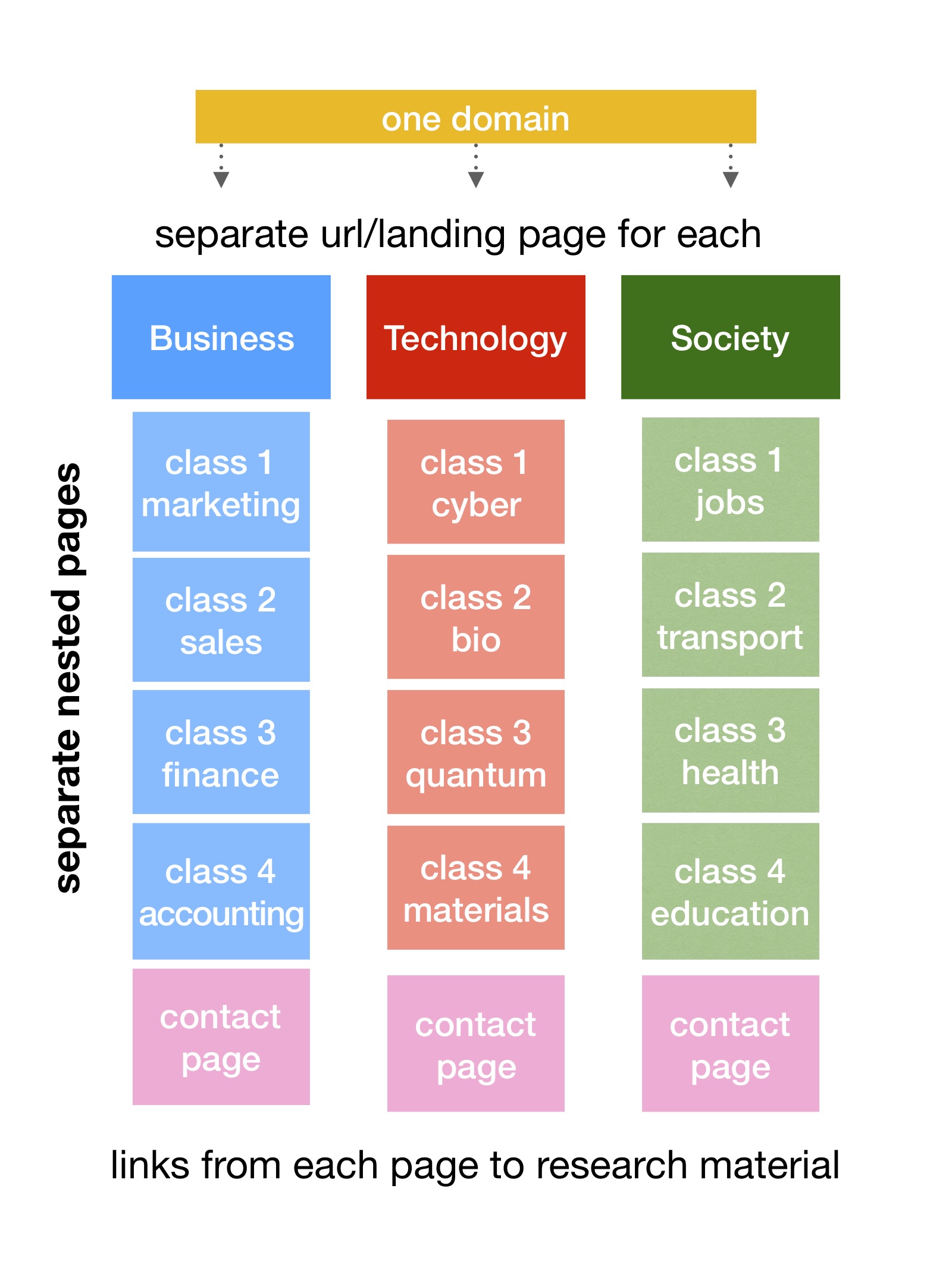

I teach three different courses and would like to post information about each course on a separate page frome the same URL. Easy enough. But, I would like students only to see the page for their class in navigation, essentially making each page a separate landing page. Is there a way to do this.

Hi Scott,
Thank you for your email and questions. I think the attached might help explain better, but the idea is one domain with a landing page for each class and then a page for each of the individual sections nested under the appropriate landing page. I am trying to figure out whether it is best to do this via the web host, which is a bit beyond my experience or whether it can be done through Rapid Weaver.
