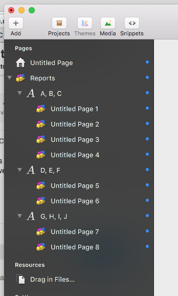

Here is an example of what I’d like. Assume a folder of hundreds of reports, I want to do as shown below. I actually am doing this now but of course i can’t use certain tools such a breadcrumbs, etc as I want the child pages to appear in “Reports”. The Styled text Alpha pages should be ignored totally by RW. I have over 800 “Reports” and there should be a way to organize within RW that does not affect RW pages and site organization.

Addendum: Here is what I’m really looking for. A “housekeeping” folder. In other words, just like making a page INACTIVE but keeping the child pages active. The child pages would relate to the next higher level “active” parent.
I’d vote for that feature.
Well, I understand that RW is trying to make RW layout “Look” like the site layout… But there should be a way to organize differently if that is what you want to do.
This exists in SiteMap Plus. You can turn off an enclosing folder but allow the enclosed child pages to show. That is exactly what I do now for my “Alphabetical List” of Reports and all reports show at same level. No sub-folders.
