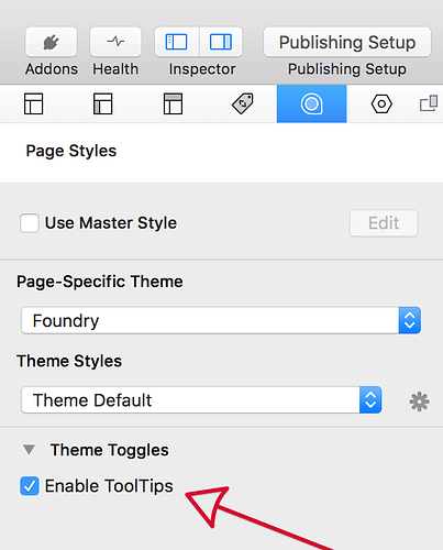

Hey all! Sorry for not getting back to you sooner. Was on a 9.5 hour flight today without WIFI! How does that exist now? Enough of that though, back on topic – The data-original-title is for the Foundry Tooltips.
If you want to use the nicely styled tooltips that Foundry provides, be sure to turn it on in the theme’s variation settings (found in the Page Inspector):

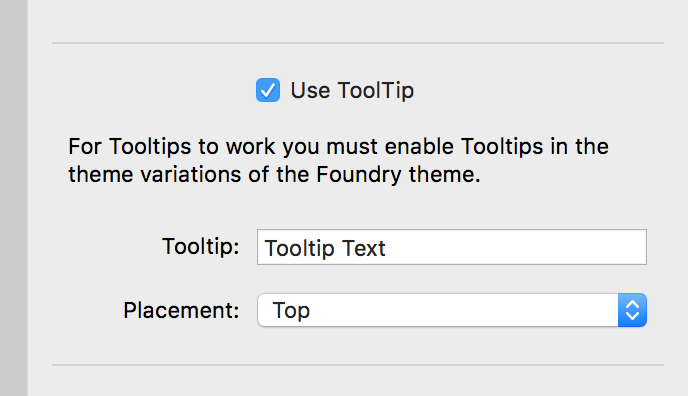

Then use the Foundry Image stack’s Tooltip settings:
