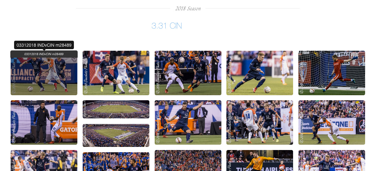

Pulling my hair out (not much left) I’ve got mouse over turned on and it is displaying the title at the bottom of the image thumbs BUT, it is ALSO displaying in larger text at the top of the thumbs at the same time. For the life of me I cannot find where to turn off displaying the titles at the TOP of thumbs, ie so just the bottom is displayed. here is the page: https://indyelevenphoto.com/RW12/photos/2018/3.31/

Has something been added to this webpage to apply popups or tooltips on links? It certainly looks like there is some additional tooltip being added onto each thumbnail link when you mouseover it.
The tooltip is even more noticeable when you set the page background to white like this:
There’s nothing showing in the web developer DOM for me at this end, which makes me think something is being added after ProGallery is done loading.
Another stack on the page or a setting in the theme perhaps? This could be worth checking at your end and might be a clue as to where these extra titles are coming from.
The Title Tooltips checkbox option you see in the ProGallery Thumbnail Grid Settings only does basic title attributes, which the web browser displays like in the examples given here:
I don’t think we have ever supported Bootstrap 4 style tooltips in this stack, for your thumbnail titles and captions. These certainly look like Bootstrap tooltips.
Foundry uses a version of Bootstrap, so this could be worth checking at your end.

In the Foundry Settings, you can select to display tool tips. Can you disable them and try again?
Wow, thanks for getting back to me Will. Your input was extremely helpful. I’m definitely using Foundry and it turns out Tool Tips was turned on at the Foundry Stack level. Totally missed it. Do apologize for not wording the request better, won’t happen again.
